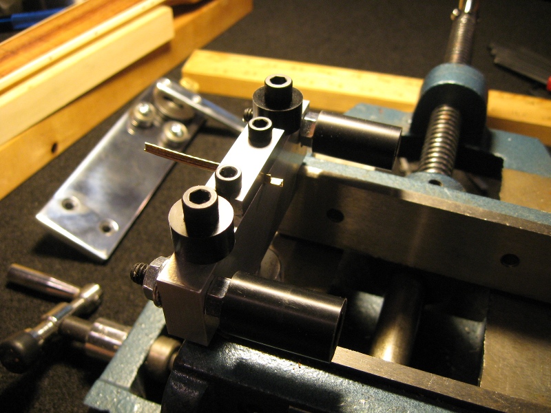

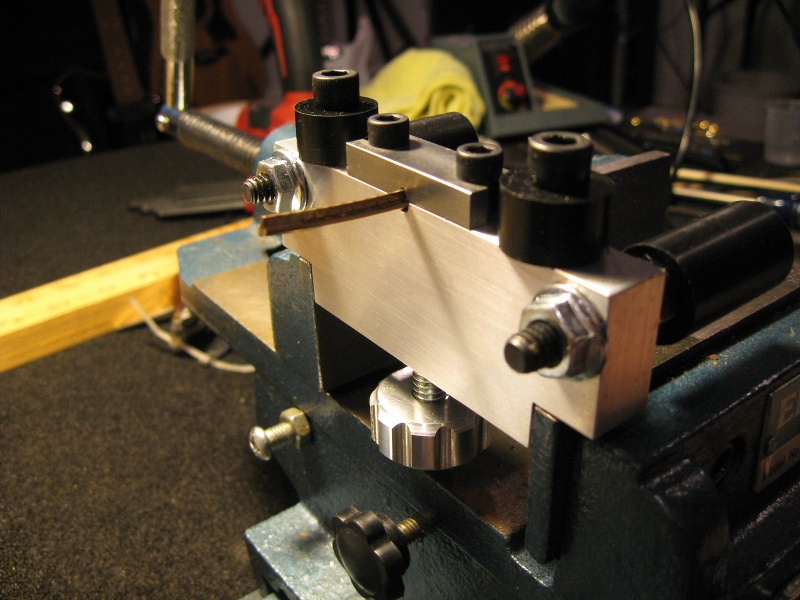

I used to have one. Several, in fact, as they don't last long. But, I recently got a nifty little jig that eliminates the need for nippers and is safer/more accurate than the dremel grinding trick...
Front view w/ tang ground off fret
Rear veiw
It's a pretty handy little widget. All you need is a medium to fine metal file. Cut the fret to length, put it in this jig to the right depth for the amount of tang you want to take off, clamp it in place with that set clamp knob on the bottom and those black rollers you see keep the file aligned so you just file away until you don't hear metal grinding any more. Pull the fret out, turn it around, and do it again. Very clean operation, and it doesn't wear out. Also doesn't care what kind/size frets you're using.
