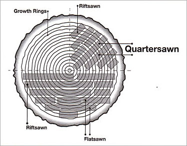

What does Nearly quartersawn mean?
does it mean they did not finish quarter sawing it?

No, it means "riftsawn", but that term is rarely heard and would raise more questions than it would answer.

OK, so I knew what quarter sawn was and why, but if Near Quarter sawn is actually rift sawing, which looks like flat sawn, what benefit does rift sawn have?
Keeps from wasting lumber, and probably allows for some dimensions that wouldn't be available otherwise. Better yeild, in other words. Quartersawn is more desirable for some things, like necks, so to be able to say something is nearly quartersawn is kinda like saying choice grade beef is nearly prime. Depending on what you're doing, it may not make any difference at all. I'm certainly no expert, but I'd expect the stuff to want to twist, but I'm sure if it had that tendency Warmoth wouldn't use it because it would end up costing them more in warranty resolution than just using the premium cuts in the first place.
