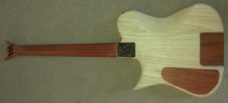

Update - been working on the guard for the tuners (and the mount point for the bottom strap button).  I also picked up a piece of 1/8" Padouk that I am going to make the cover for the rear route out of.  I've been working with my router and an inlay bushing to get ready for that cut.  I've also made an inlay out of the Padouk to go in the inset for the tuners on the back side - I think the accents on the back will look great.

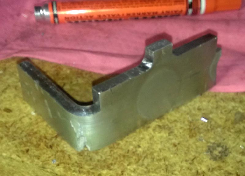

On the bracket my first attempt failed - I machined it flat and then attempted to heat and bend it and it just let go at the bend:

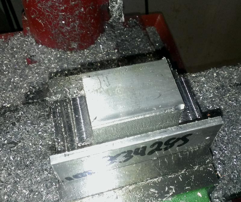

So I started again with a solid 2 1/4" x 2" x 4 1/4" block of aluminum - made a BUNCH of aluminum shavings tonight and got through about half of it:

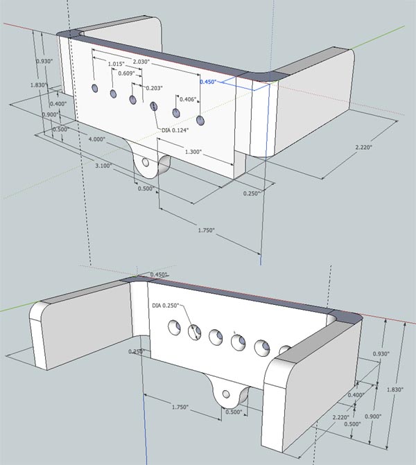

Here's the design of the guard (drawn in Google Sketchup):

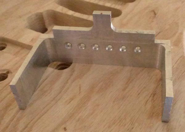

I finished the machining on the tuner guard/strap button mount over the weekend.  Just have to do a little rounding over of the edges and  paint it and it's done.

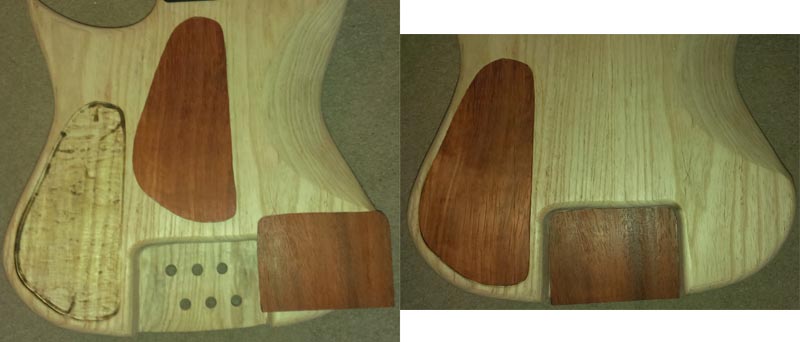

So . . . after a LONG layoff on this project due to 1) health, 2) winter (a couple times), 3) getting up the guts to plunge the router into the body again - I'm finally making progress again.  I'd never used a router inlay kit (bushing) before and was VERY afraid of ruining all the work I put into the body in getting the control cavity cover made and fitted.  Did a couple test pieces over the last couple weeks (which really wiped me out physically) and finally got the guts to do it on the body today.  Man, swamp ash burns REAL easy with a small router bit - it start smoking the instant I'd plunge the bit in.  But it looks great!  Will have to rest up over the week and I'll probably get the rest of the control cavity opening carved out (that should be easy - already have the template made), then it's just drilling the holes for the controls and then finishing the body :) .  After messing with the tuners some more I've decided that I'm not going to use the guard - don't think it's necessary.  The bottom button is going to go just above the tuner cavity instead of being centered.  Inside the control cavity is also going to have a padouk inlay.  Can't wait to have this project complete!

I've routed out the control cavity and fitted the control cover and Padauk inlay where the tuners are (match the Padauk neck) .  However, when I did it I went too deep and made the top too thin in that spot.  So I've glued in a reinforcement there.  Everything's now been fitted and sanded.
