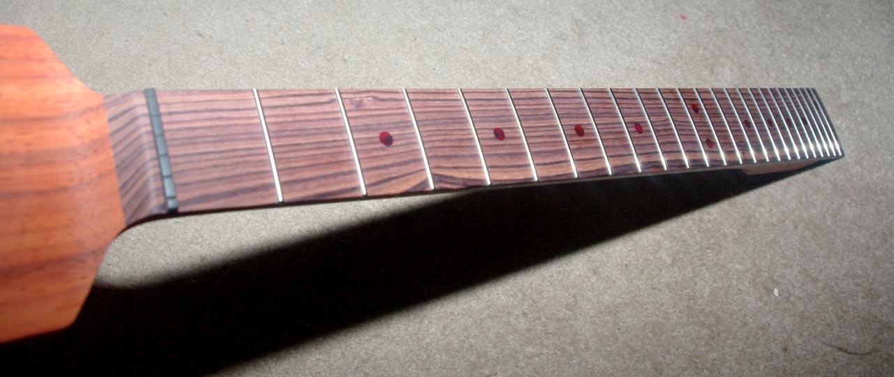

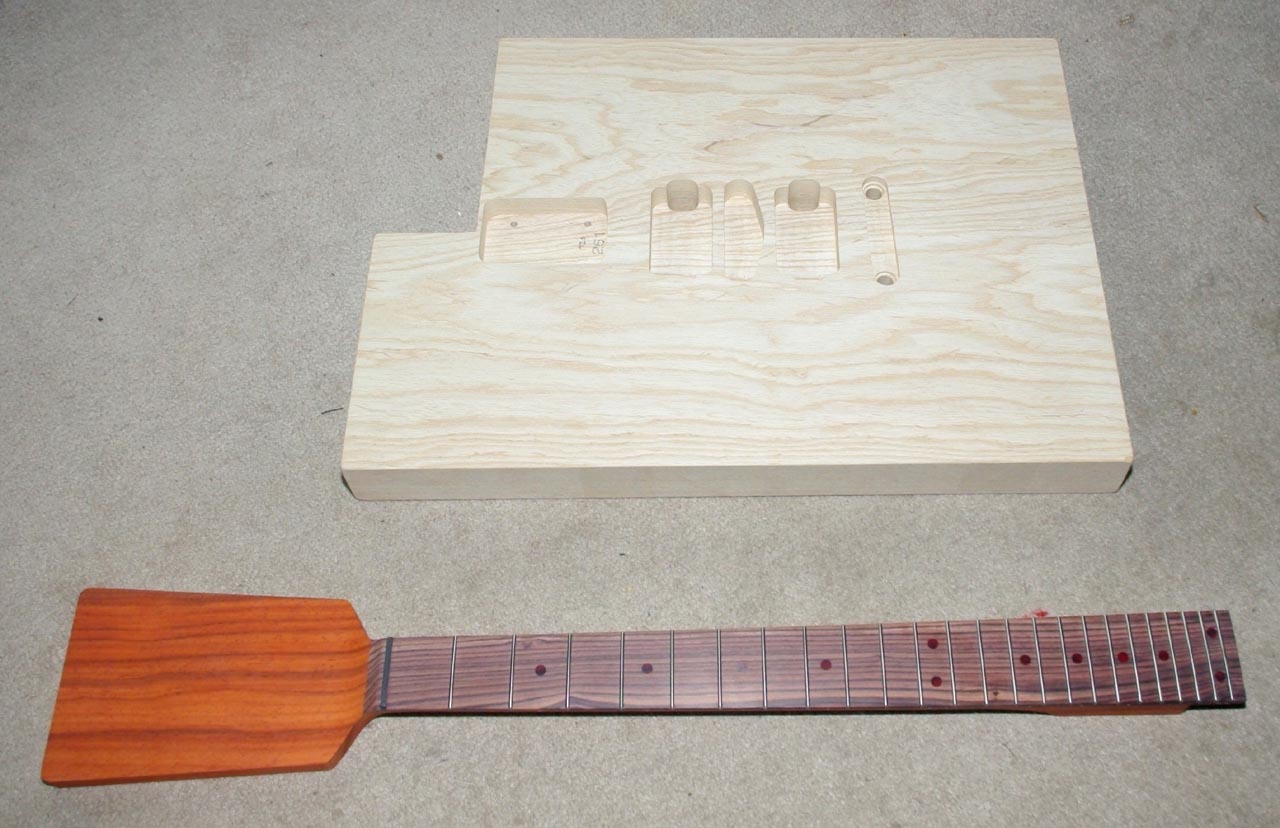

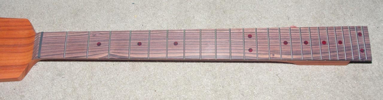

The body and neck have arrived - just waiting for a couple pickups that are on back order and the wiring harness now.  I'll be getting to work on it but it's going to take a little while at 30 minutes a week or so.  Decided to go with the Jasper bloody basin inlays and I love em - they look better in person.  I'll post updates as progress is made.
That fretboard is really attractive. Body looks a bit square for my tastes, though...

Great looking neck  :o
Lovely those Bloody Jasper inlays  :headbang:

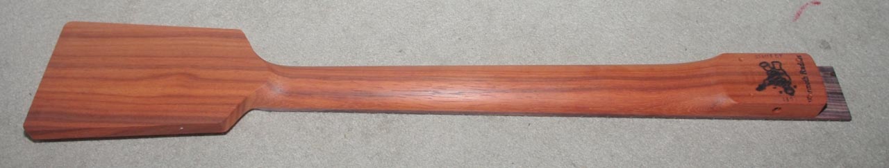

So what are you planning to do with the bit of headstock you cut off?  It's way too pretty to go to waste. I'm having mine planed down to 3/8" to serve as a pickup cover & "ramp". You obviously couldn't do the same thing with yer pickup configuration, but do you have a final design for the headstock?
I might take the extra piece off yer hands if you don't have any other use for it.  :glasses10:
It definitely won't go to waste.  I'll either be doing something with it or I'll be giving it to my father in law who helps me out with stuff and he uses all sorts of exotic woods on different projects.  I'm about to ask him for some backing boards for my new corner of the room for my gear to put a bunch of wall hangers on to be able to hang up the whole collection.  I've been using a floor stand in addition to a couple wall hangers but we have a 5 month old husky puppy right now who likes to chew so everything's in the cases except for what's on the wall and I prefer to have them all out (otherwise they don't get played as much).

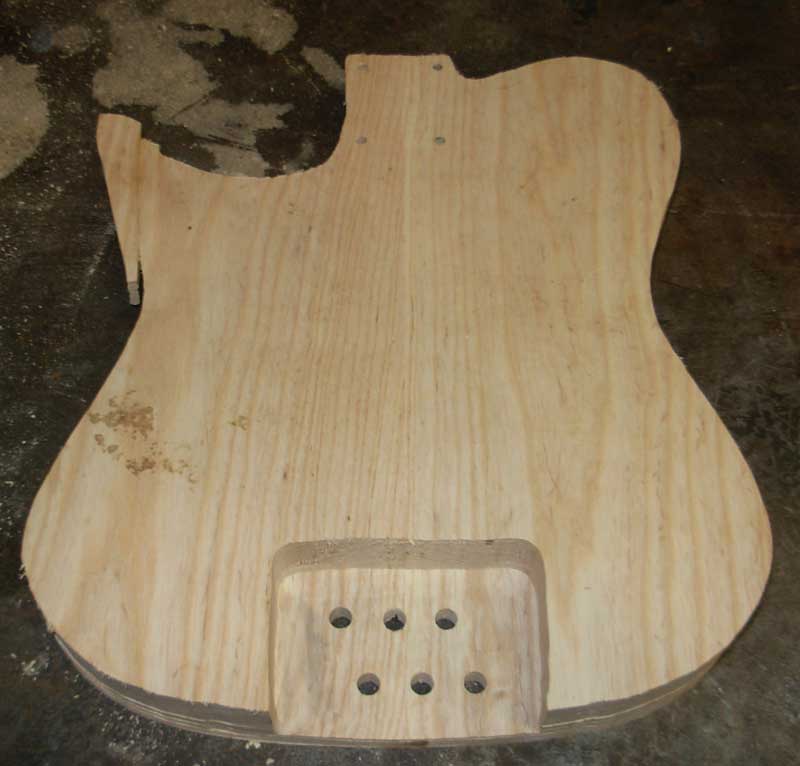

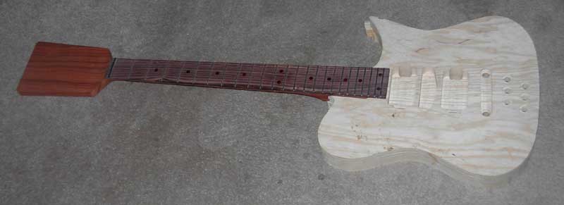

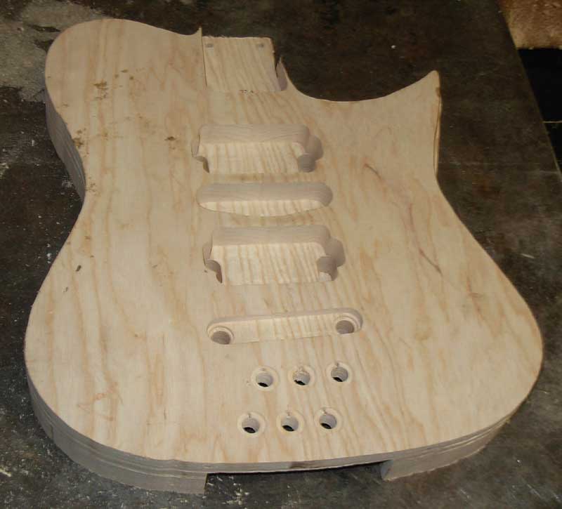

Well, had a rough few months - been in the hospital twice since the last time I posted on this.  Finally felt well enough to get some work done on it this weekend.  I took a bunch of pics but my SD card lost them for some reason so I went back and took a few.  Got the body cut out and the holes cut for the tuners.  I decided to countersink the tuners a bit to get the knobs a little closer to the back of the guitar.  I also spaced them out a bit more than I did in my prototype - I'm glad I did the prototype as it showed me where I needed to make some changes.
When I was routing the outside of the body a piece tore out - you'll see it in the pics as an unfinished chunk sticking out.  I glued that piece back in and I'm going to let the glue set for a week before I route it again.

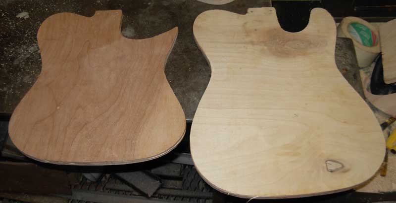

Here are my templates.  I made the tele one from the SX furian above and then I cut out another tele template from that and modified that to make the new design.
Here's the body.  Still have some cleanup work to do on it (in addition to finishing the repair mentioned above).  I also still have the control cavity to route out and am going to bevel the heel.

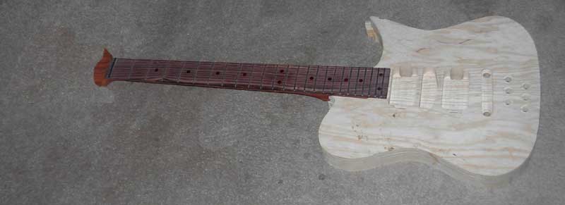

and here's the guitar mocked up with the neck:
and with a little photoshopping of an approximation of where the headstock will be cut off:
