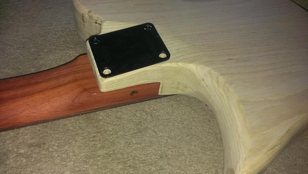

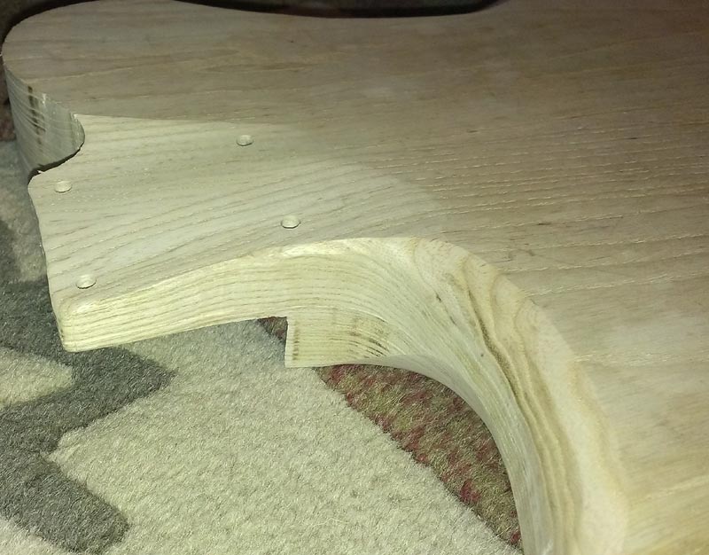

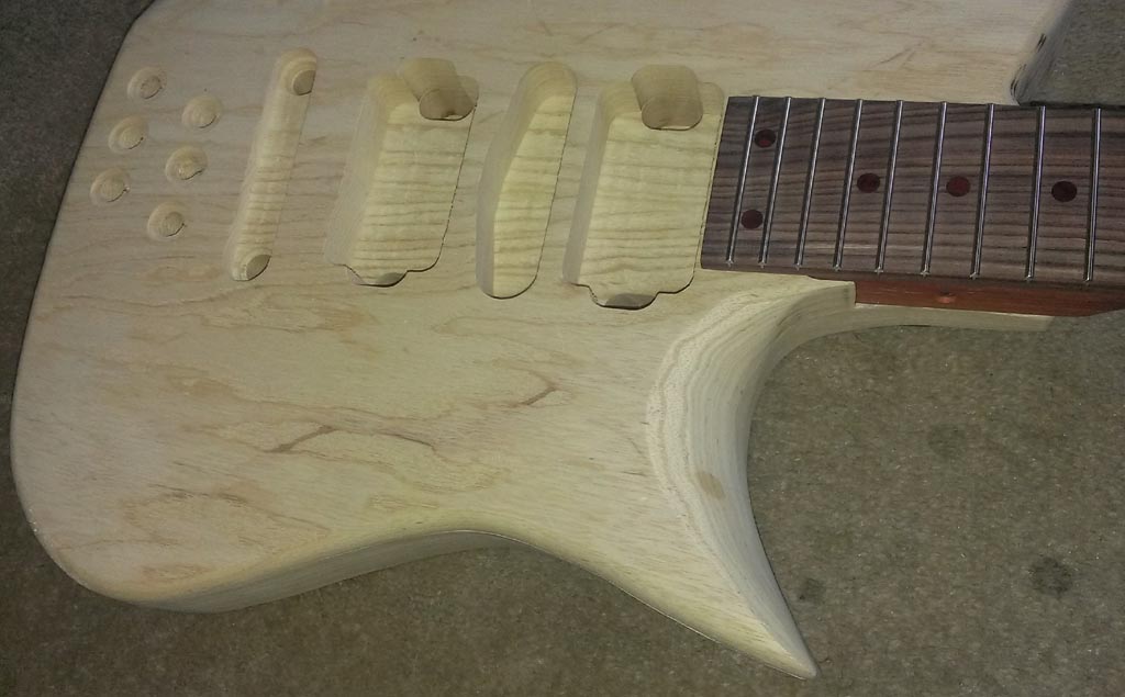

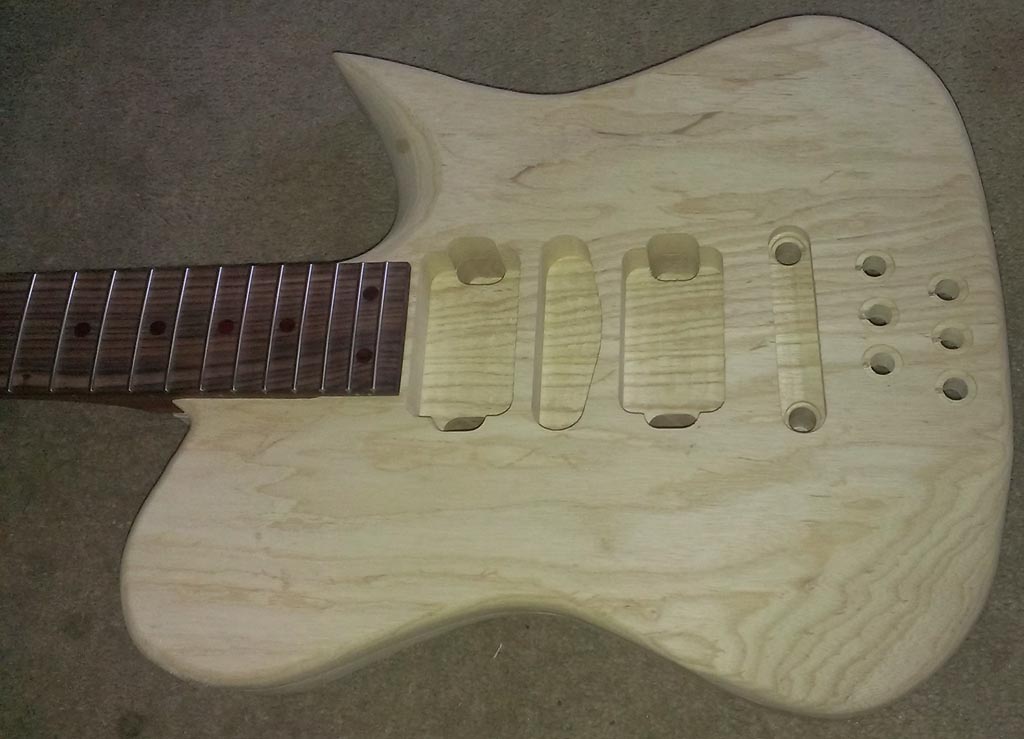

Thanks guys, I'm starting to get real excited!  Made some more progress tonight.  I finished up the repair and got a good start on some contours and a contoured heel.  Between the contour on the body and the heel access to the 24th fret is going to be REAL easy!  Feels awesome already!

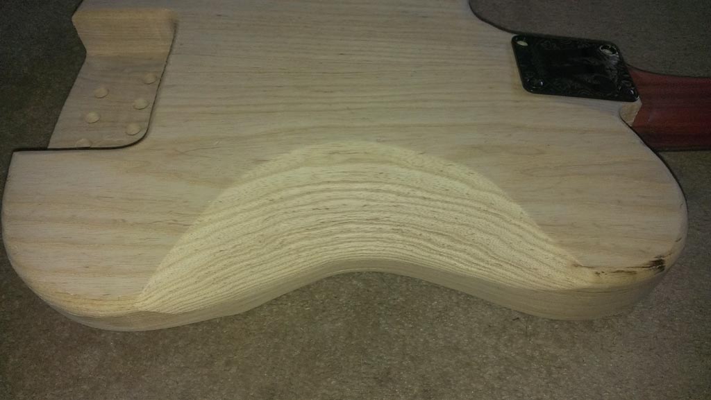

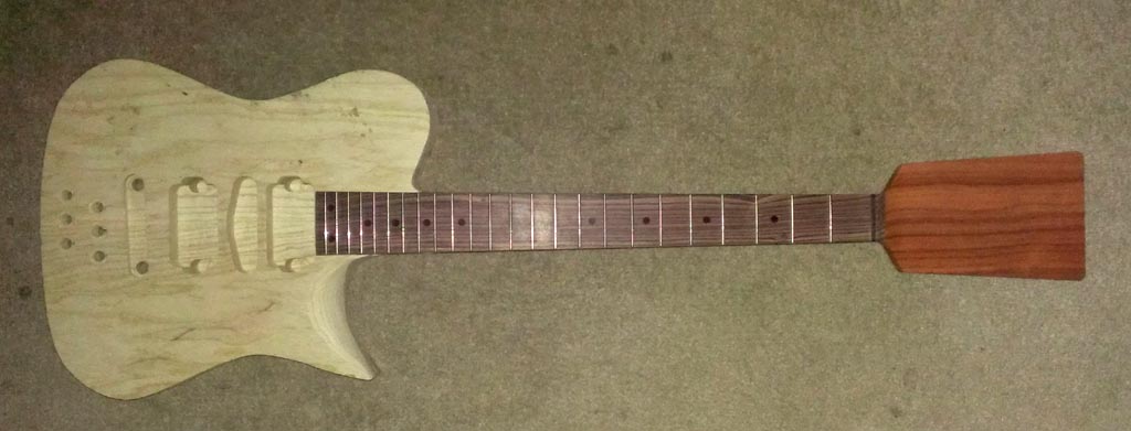

Had another medical setback this week and ended up in the ER in the middle of the night wednesday with difficulty breathing and swallowing (complications of my polymyositis) - but my rheumatologist was able to get right on it and changed my meds and I'm doing ok.  Did a bunch more work today.  Finished up the contours on the body and rounded over the edges, etc.  The only things left on the body are to route the control cavity, drill for the controls, and then final sanding and finishing - I LOVE how it came out.  I also did a prototype headstock and I like it too.  Here's a picture of the guitar with the prototype headstock photoshopped onto it:

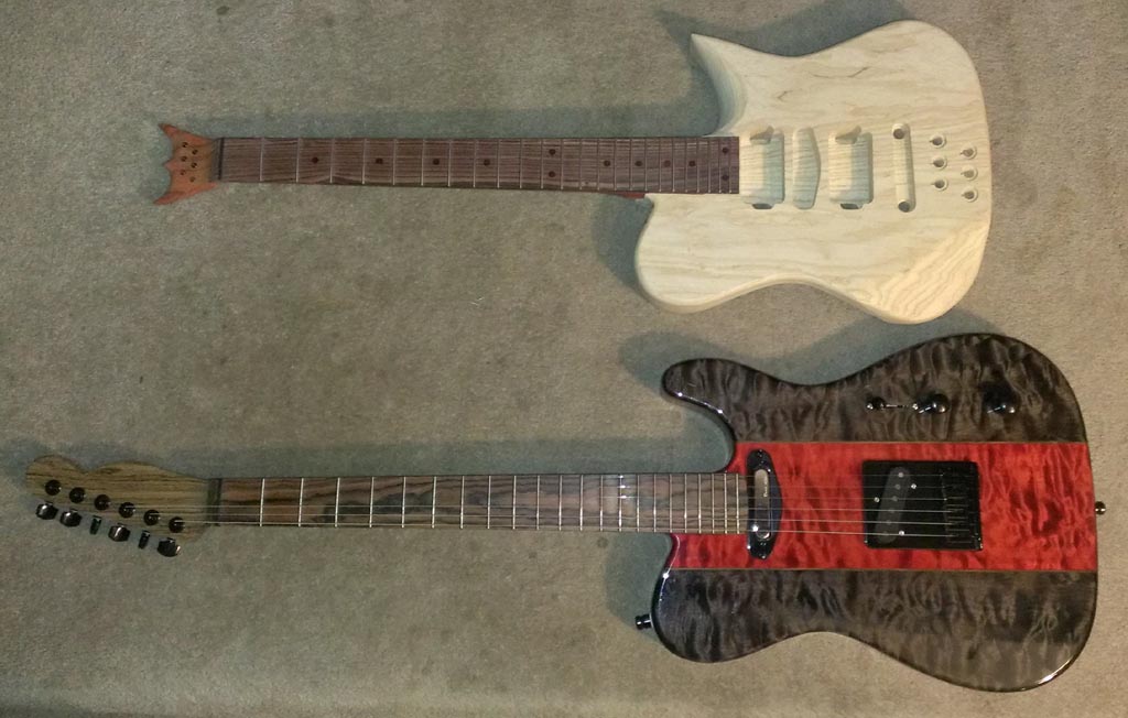

Here's the guitar laid next to my Tele to give you an idea of the size difference (note the scale length and how the guitar lays on my leg is EXACTLY like the Tele so it feels like a full size guitar).  Note the headstock will actually be about a cm shorter than it is in this pic - I left extra material there just in case:

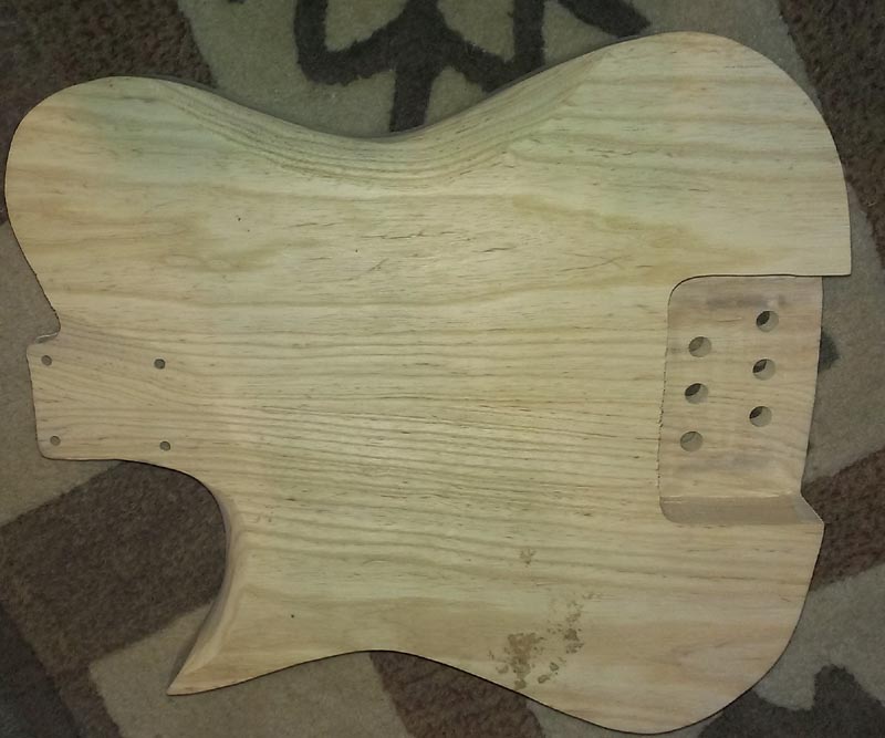

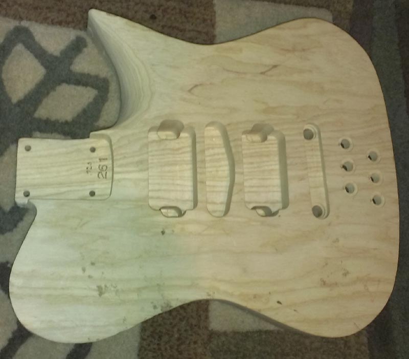

and here's some closeup's of the body and the contours, etc:

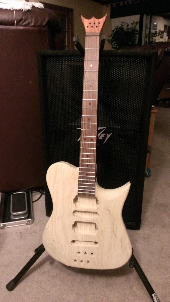

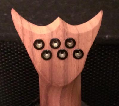

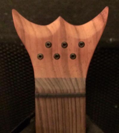

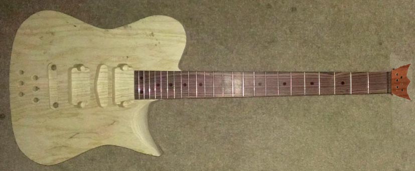

Finished the headstock tonight and got the ferrules mounted.  Took new comparison pics against my tele and close up pics of the headstock (going to remove those pics from above since these are better):
I know I wrote the screaming mee-mee alert about no-butt guitars and the way guitars get swallowed by upholstered chairs, but you got enough of a lower-bout bulge there to lift the strings up out of the hole. It ought to be just fine... I poked around the Strandberg site and he's making guitars with no-butt AND no-dangle (so to speak) and grandma's puffy pink chair would be hard to negotiate with a Strandberg.
This thing is looking mighty fine  :icon_thumright:
Great work !!
Love that neck.

Yes they are bloody basin jasper dots.  They really don't photograph well - at least I haven't been able to get a good picture of them.  They look incredible in person!  Thanks for the positive comments.  I'm getting really excited to have this one done.  Feels much more like MY creation than any of my other guitars for sure.
I strung it up tonight to see how high the tuners are going to stick out because I'm going to make a guard to protect them and I didn't want it any taller than necessary.  Played it for a while to get the feel of it - LOVE IT!  Can't wait to have it finished now.  Finishing supplies are supposed to arrive tomorrow.
