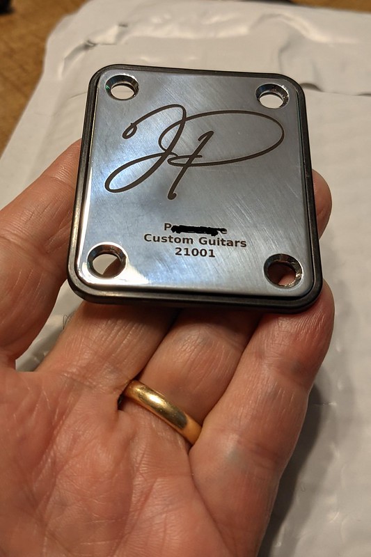

Finally for this weekend I'll throw in an unsolicited endorsement for the place that did my custom neckplate.  I took the logo that I made for the headstock, and added a label and serial number for fun, then submitted it to LazrArtStore.com.  Came back in a few days, and included 4 screws and a black plastic cushion backing.  I couldn't be happier with the look.
Had trouble with lighting on the reflective chrome.  This will have to do for quick and dirty.

Finally for this weekend I'll throw in an unsolicited endorsement for the place that did my custom neckplate.  I took the logo that I made for the headstock, and added a label and serial number for fun, then submitted it to LazrArtStore.com.  Came back in a few days, and included 4 screws and a black plastic cushion backing.  I couldn't be happier with the look.[/img]
I purchased mine from the same dealer and was very impressed and pleased with their work! An afternoon designing a backplate and it was good to go! Mine covers the entire surface, so it's not as reflective haha.  https://imgur.com/a/LoGb4x2
