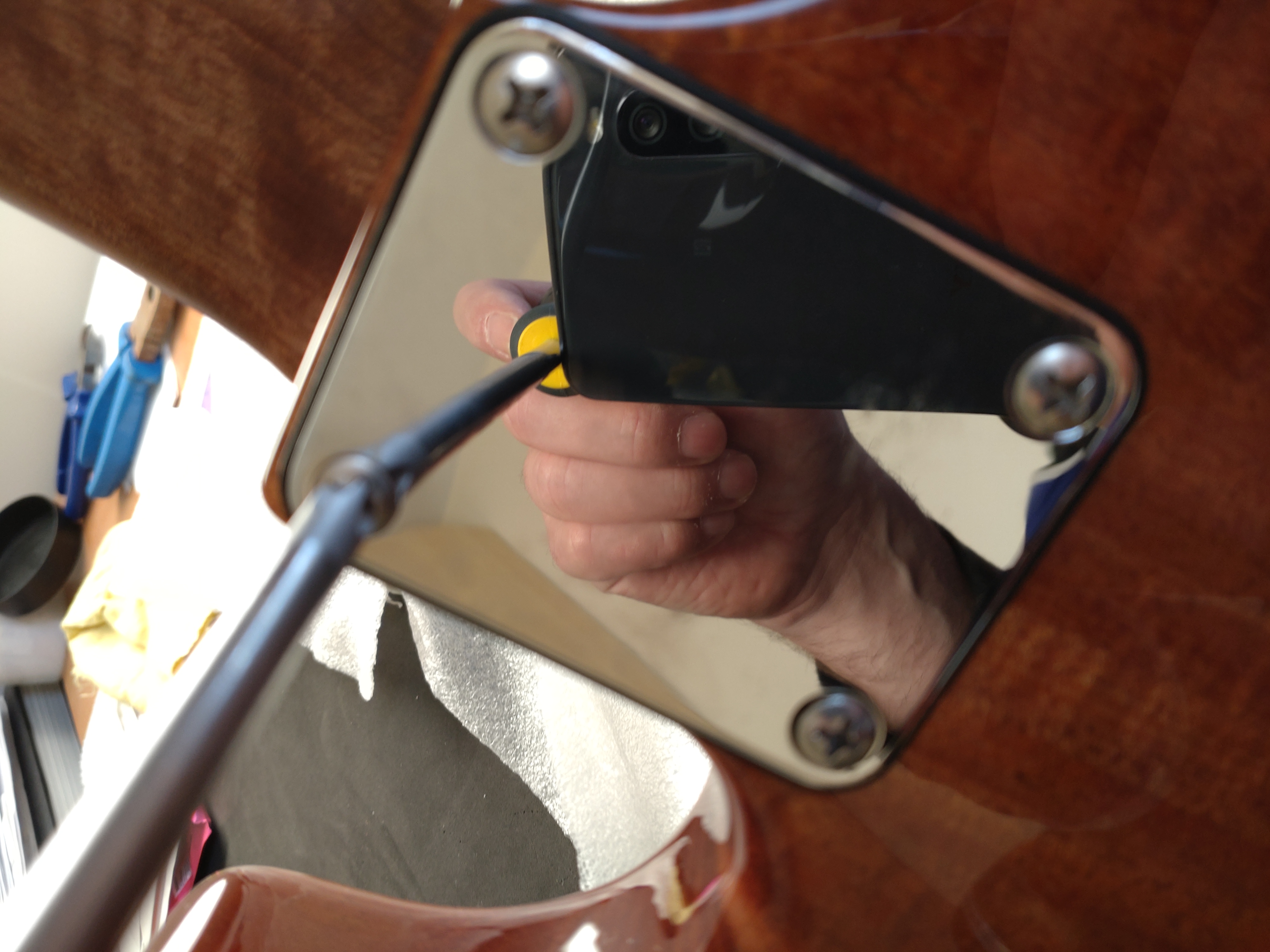

Now the strings are on with some tension I loosened a turn or two the neck screws, which then allows me to nudge the neck slightly so the outer E strings are aligned correctly.
Then the screws are retightened...
NeckAlignment by stratamania, on Flickr
The alignment is then done. Though it is difficult to show in a photo due to the various angles etc. It doesn't help that neck position Seymour Duncan mini humbuckers have polepieces slightly wider than the string spread but it is what it is...
Aligned by stratamania, on Flickr
