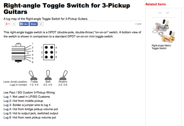

I didn't pay enough attention to my schematics and had to order a switch with more poles. This selector switches Neck, Neck/Middle, Bridge.

The P/G took me a little over an hour. Well, it took me about 2.5 hours in all because there was some troubleshooting once the guitar was setup and played. I read the schematic wrong and grounded half the hum bucker (whoops). Notice how the red and green wires are not grounded (like the blue and black), but simply twisted together? :icon_thumright:

I found this schematic on a forum and snatched it.
