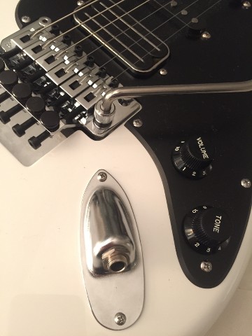

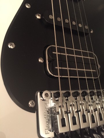

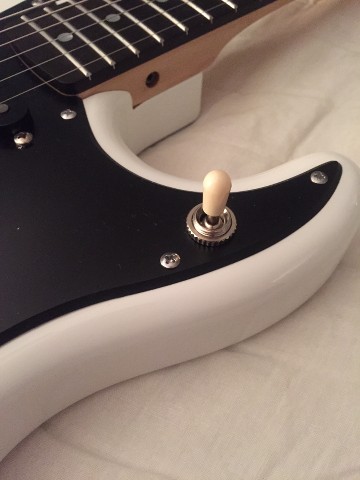

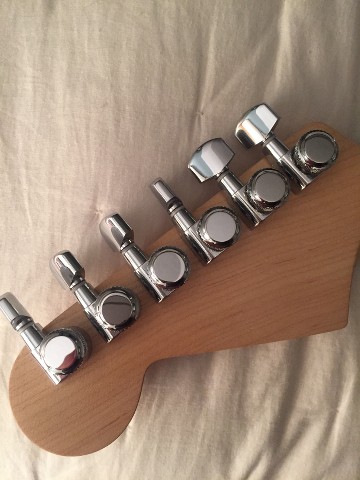

Here's a couple quick snaps I took with ye ole iPhone:
Awesome! White strats with black pickguard = the best
I like the out of the ordinary switch placement.
And you just gotta love to have no bolume pot in the way right under the strings  :toothy12:
I agree - black-on-white Strats are the whip, and I need another one. I think it's a common desire because it seems like every time I build one it gets sold. I'm not quite as enamoured of the displaced volume control, though. While I don't use my controls as much as some or even many do, and almost never do volume "swells" with my pinky, I don't like my controls out in the tiddlywads. This one isn't as bad as most Gibson-esque designs, but still. Don't wanna be looking around for controls. Should be able to grab them instinctively and immediately. Plus, I'm not a very animated player so having the controls close at hand doesn't put them in my way like it does for some.

It worked out really well and nails that 80s Lifeson tone. The only departure from the norm was my choice of trem. I cant stand double locking units especially for string breaks, so I opted for the Wilkinson. I used locking tuners and I can dive bomb like crazy and she still holds tune. Specs
Heavy ash body
Ebony board neck
Locking tuners
Wilkinson trem
Wylde L500
2 Fender CS single coils
