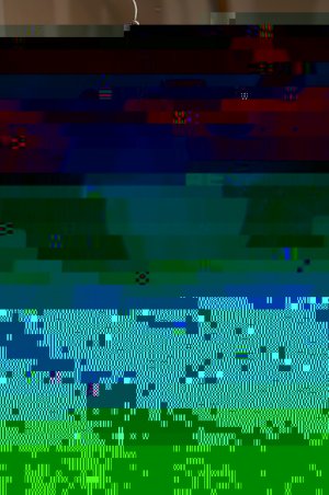

Well, after my first went so well and was so much fun (The Booger, see below), I wasted little time ordering my second body. I decided to try a burst finish with this one and seeing as I live in a townhome with nowhere to spray, decided to use dyes for the burst and Tru-Oil for the finish. It has been going very well so far. The goal is a sweet classic bluesy SRV style strat tone with an exotic look.
As you can see from the 1st shot, the body is an alder core with a flame maple top. I tried to tape off the top to minimize my sanding after dying the top, but it penetrated and was essentially useless.
I used a mixture of Transtint Reddish Brown, Honey Amber, and Bright Red in water to do my colors. I started with a base coat of reddish brown to pop the grain, as seen in the 2nd shot. This was sanded back to leave dye in the grain and then I added a coat of the honey amber. I then removed the tape and dyed the back a mixture of the reddish brown and red. Then, I used both this mixture and the honey amber to create the burst. This was much easier than I anticipated. The key was keeping both colors very wet and allowing them to blend. It was very easy to fine tune. Unfortunately this raised the grain and I ended up repeating it with sanding multiple times to get the grain flat. After it was done, I had the color you see in the last photo.

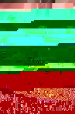

So then I started with the Tru-Oil. It has been an adventure in lint prevention. I started with a cut up old T-shirt but got some lint that came our with a little Naptha and some sanding with 4000 and 600 micromesh. I have been applying very thing layers with a coffee filter and this seems to work well. Every 3-4 coats I have sanded with 4000, 6000, and then 12000 micromesh (wet sanded with water).
It's coming along well.

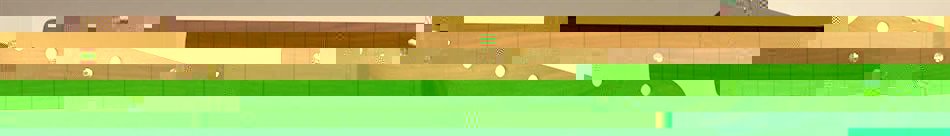

The neck will be the pau ferro/pau ferro with abalone inlays you see below with 6100 SS frets and schaller locking tuners. I will be using Lollar Blackface pickups and a parchment colored perloid pickguard. I think its going to look amazing! Will post pics with more progress...

You can also see how much the tru-oil darkened the finish. I think it matches the neck really well. The pictures don't do it justice. In the sunlight it literally glows.  :party07: :headbang1: :guitarplayer2:
I was very worried about how the alder would take the dye after reading reports of it being splotchy, but it could not look better. With the reddish dye and the true oil, it has an amazingly rich reddish mahogany look to it that really accentuates the grain. I'll post some pics of that too.
