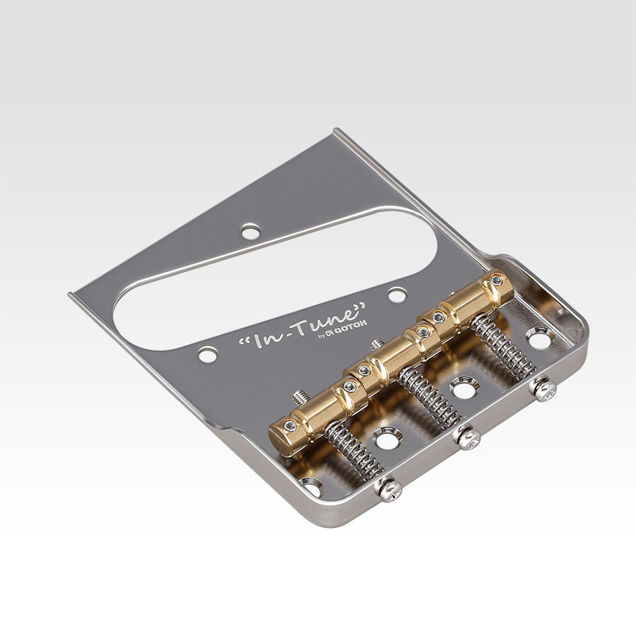

I think the reason Gotoh wrote it the way they did is that in Japanese, it makes sense, and the translation to English was done by an intern who spoke "good enough" english .... Nothing more. Be confident that the bridge plate is not made of titanium.

The problem is that Gotoh doesn't clearly states the plate material. Check the description of this bridge, where it says "Titanium construction...." that makes one think it's made of titanium. They ONLY state the saddles metal, brass OR titanium, depending on the model label startin with Bs or Ti.
Check:
Well my Gotoh Tele bridge plate is definitely not titanium.
