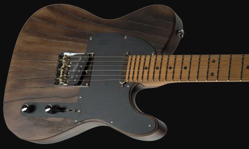

The closest thing to this seems to be the Wilkinson WT3, used by Suhr in his signature Tele below.

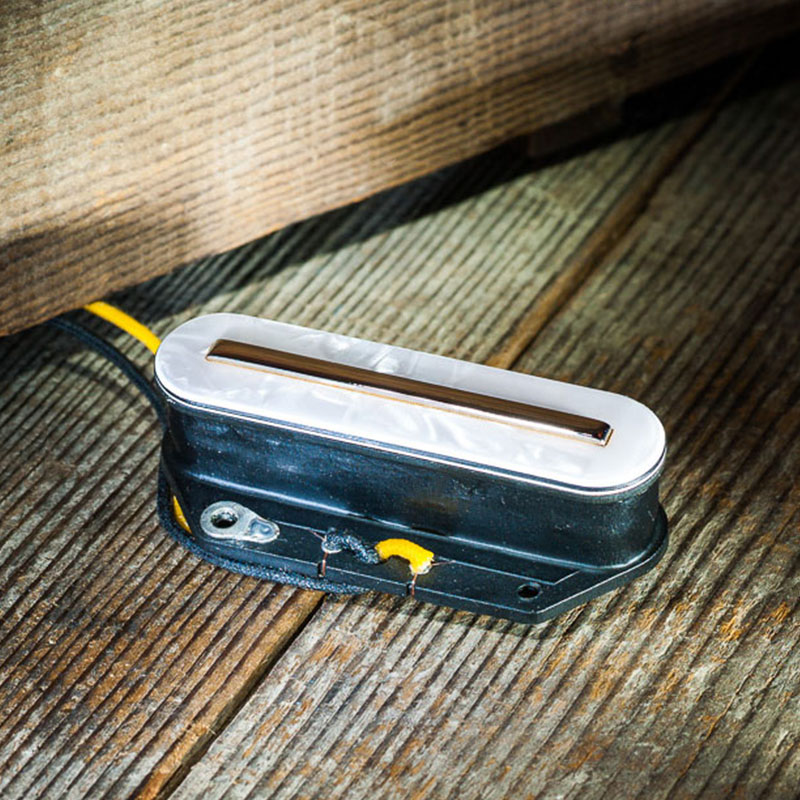

Pickups are a set of 3 Lollar C.Christian.
You must be planning on using one these in the bridge position, not an actual Christian? ...

Yes, of course it's the B.S. + 2 CCs.

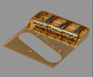

This may be it! Unfortunately it's not available on my country's Amazon nor they ship but I found they have their own shop online, Musician Outfitters Store.
Measures look good. Metal is right. And cheap! Worth a try! THANKS!!!!!

Looking at the bridge Suhr puts on his Tele. The picture is above....
That's a Wilkinson WT5 custom made for Suhr. It has the wallsides cut AND a couple of extra screws at the top end of the plate. Those will tight the plate way better to the guitar body for much stronger sound transmission.. Gotta say... that's probably the best vintage style Tele bridge with modern enhancements. Suhr knows his shit, for sure! 👍 👍 👍
