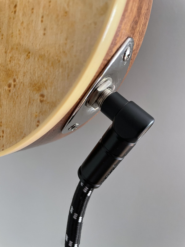

Would it also work with a square plate? Maybe if you were to form it to the body? Football jack should be okay, as long as I can use my angled cable.

Regarding jack hole, forget about what you read elsewhere.  7/8 is what you want. No you do NOT have to use electro socket. None of mine do.
More people than not you have commented on the 3/4 hole note it is finicky about having enough room for the wires and the legs to spread when a jack is inserted.  Consider yourself warned numerous times to change this to 7/8.
Keep in mind a good portion of the audience here have built multitudes of guitars and basses.  Other forums, your lucky if you come across someone that may know enough to correctly even work on a guitar.
It will work with some square plates but often they may be dimensionally too big. A football plate will work with an angled or straight plug cable.
Yes, use the football plate. It will look nicer with the round overs on a strat.

Rugby/football plate on a 7/8” hole with a right angled jack. This plate is recessed so the socket doesn’t stick out as much
