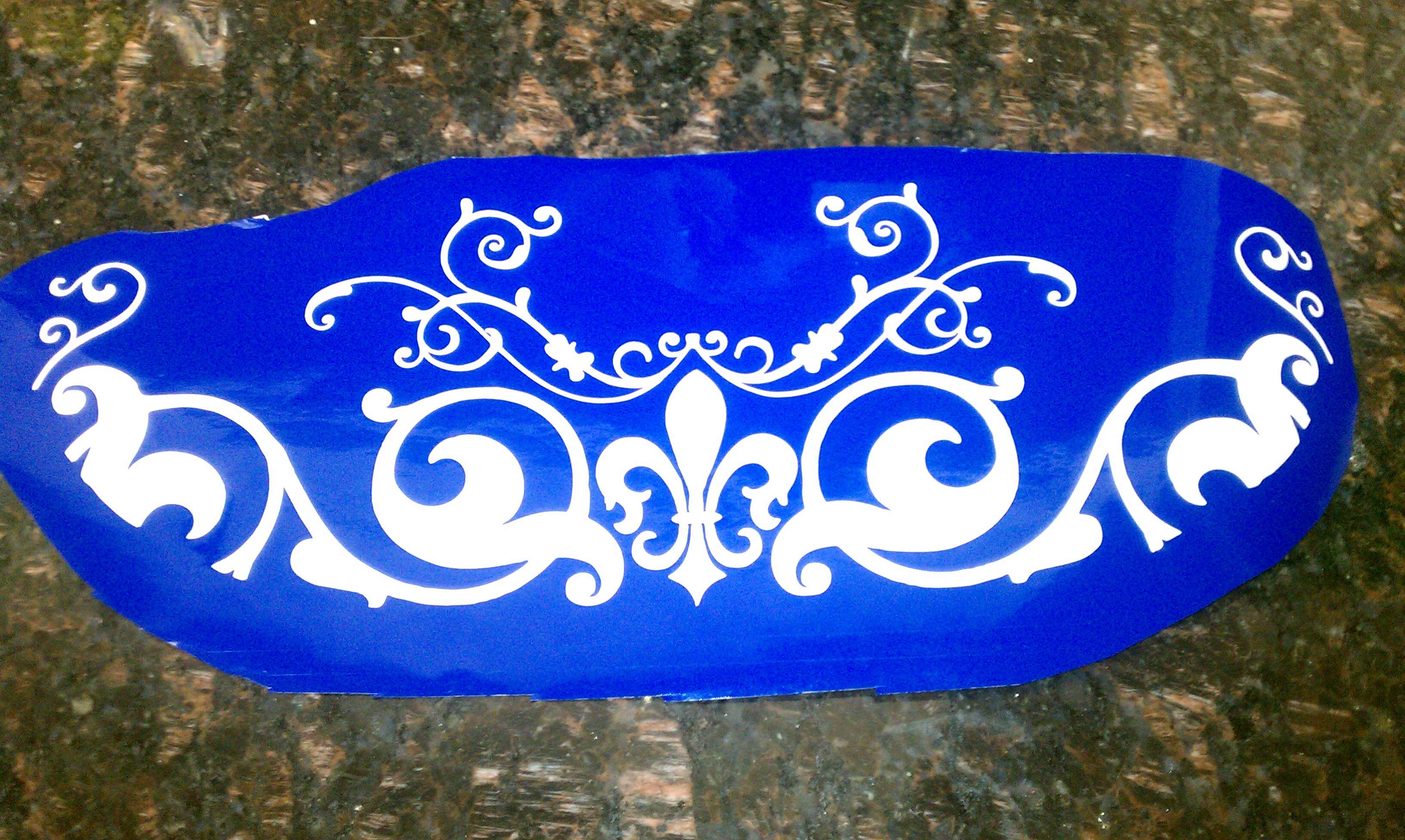

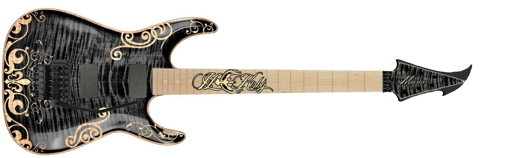

Kuro Uma said:This is the approximate goal of what I intend it to look like.

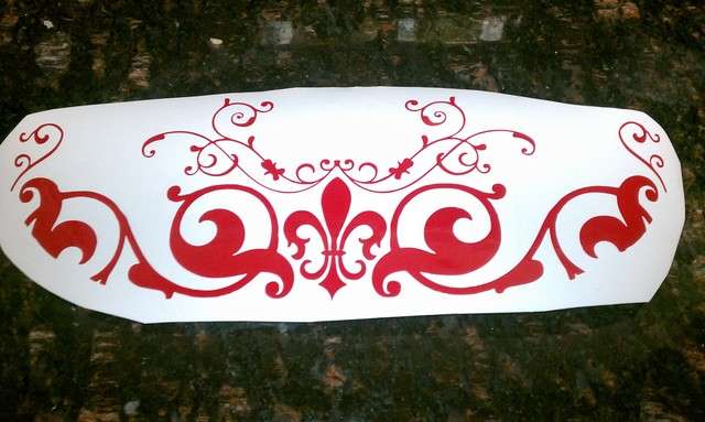

ubershallman said:I've never done it but I hear that spraying the dye helps also. Supposed to make for a cleaner edge.
Kuro Uma said:ubershallman said:I've never done it but I hear that spraying the dye helps also. Supposed to make for a cleaner edge.
I have a blue dye in aerosol can i got from re-ranch. my black dye is a water based dye in powdered form. I practiced the method i plan to do on a few pieces of scrap maple. masking off where i want the design, sealing it, then masking that off and wiping on the water based dye. It seems to come out very defined. I do have my concerns with such an intricate design though.
I thought about spraying the black dye. But I'm not sure which way would be best. I picture just creating my normal black dye mixture. dumping that into an airbrush and going at it lightly. But after the wipe on method came out with a defined edge I stopped there.
If I could locate a black dye I could spray on I'd go with that. Preferably in an aerosol as I don't have a lot of access to spraying equipment.
Bagman67 said:You could use a preval unit: http://www.woodcraft.com/Product/2005751/16922/Preval-Complete-Spray-Gun.aspx
