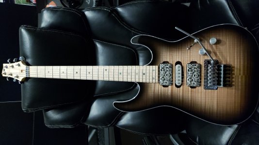

After getting a body and realizing it didn't have the 720 mod, sending it back, having it remade then sent again, I finally have it about 80% together, enough to show it off in all its glory. This has been way too long in the making and turned out way better than I thought it would!

Looks great. I really like the neck. Something about it, maybe the color, maybe the headstock, really makes the entire guitar pop. I think the entire guitar looks incredible.
How did your setup go? Any tricks needed to balance the 720 mod and Floyd? My guitars all have standard pockets and fixed bridges so any insight would be appreciated.
I'll get some more pictures once I have the rest of it done on the back and inside, but man that is the problem I'm currently having. Don't think it'd have to do with the 720 mod, but the floyd doesn't bounce back to pitch. Setting it up, it's level and in tune, but as soon as I pull higher or lower, it stays either at a higher or lower pitch from whichever I pull it. Thinking it has to do with the springs.
But thanks for the kind words, been really happy with it so far. Just need a lower action and the correct wiring but all in all, it's a dream.
Any chance it’s making contact with the body and binding somewhere? I know zero about Floyd’s but since it’s getting stuck at both extremes it makes me think it might not be just the springs. Again, I have zero experience or knowledge of those terms.
Curious about the 720 mod. Did it allow you to achieve lower action? Where did you set your relief and action?
Warmoth's recess cavity for that style Floyd is cut very close. While that's aesthetically pleasing and generally works fine, I've had a couple occasions where I had to open it up just a smidgen, or else there would be friction between the bridge baseplate and the sides of the cavity, causing an inconsistent return to neutral. I suspect it has to do with the manufacturer or vintage of the bridge itself - they're not all exactly the same width or have their pivot points cut in exactly the same place. Doesn't need to be off by much for it to be a problem when clearances are that small.
I have found this as well, near the treble side stud mount corner of the route.
I actually found out the saddle screws are digging in slightly under the trem. Hurt the paint, but only slightly and it's completely covered. Took a dremel and shortened the excess on each screw since it's a pretty low action, set up real nice. Fixed the issue! Did chapstick on the joints too, so the only thing I need is to fix my wiring, get some screws for the trem cover and a football jack cover, and we'll be picture perfect.
