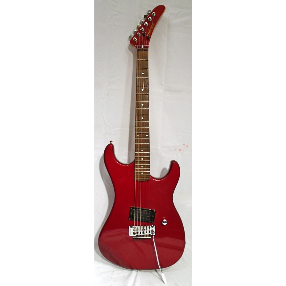

15,456
In the 80's before I got an actual Kramer Beretta, I bought Kramer Focus 100ST, just like the one pictured only in black. It has the non fine tuner Floyd and no locking nut. And I wanked the crap out of it for more than 20 years and never had any trouble out of it. But any guitar even without a trem can go out of tune. Even a stop tail bridge has it's problems. Les Pauls have been notorious since the beginning of time for being unstable...
