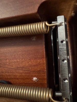

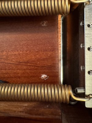

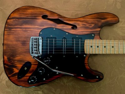

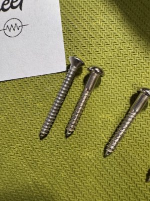

I built a strat recently with traditional six hole trem route. Initially I had a Floyd Rose Rail Tail in it, then tried a Vega trem. I know one is decked and one floating but it's my first strat in a long time and I wasn't sure about floating v.s. decked. In any case, one thing I found out is that the Vega trem screws are longer, long enough to poke through the trem cavity in the back. Not a big deal but just thought I'd post about it.
Otherwise both bridges fit the route and were pretty easy to install/set up.

I just wanted to try both. Very used to playing fixed bridges so I thought the rail tail would feel more familiar, which it definitely did. On this particular guitar though the Vega had a different tone and one that I really preferred. I didn't like the feel of it on bends though. Everything was off. Weird. Unsurprising of course after years of playing teles and LPs. So I thought this is too different and put the rail tail back on. And I just missed the Vega, it sounded different and to me better. I've had this experience with LP bridges in the past so I wasn't that surprised. I don't want to open the can of tone worms here so take it all with a grain of salt. Just my experience.
So I put the Vega back on and am going to learn how to live with it and use it. Nothing against the Floyd, beautiful bridge, very well designed and built like a rock.
Also definitely not saying one bridge has a better tone than the other one, merely that on this guitar to and to my ears they were different and I liked one over the other.
