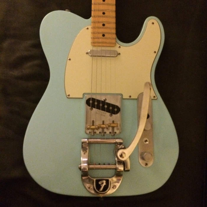

Hey! I just noticed a difference between the B5 Fender and the regular B5: The B5 has one of the fixing screws located ahead of the spring on a little 'nub' that sticks out towards the bridge. The B5 Fender does not have this; rather that screw is hidden under the spring; the little 'nub' is not there. Worth noting if you don't think you've got room for that little nub on your telecaster. Also note that the other hole locations appear to be different as well, which may affect which vibramate you order.
well I already ordered the real B5 and matching Vibramate, so let's hope it fits. (It must, right?)
There is more to it than the nub.
The F-logo Bigsby is actually longer, with both rollers moved forward. It is a much tighter fit between the tail and bridge than a B5 and puts the roller much closer to the bridge.
imageuploadedbytdpri1394065184-409682-jpg.223312
The B5 is more compact and can placed further back from the bridge for a less severe break angle.
Although the Vibramate has to move it further forward for the apparatus.
