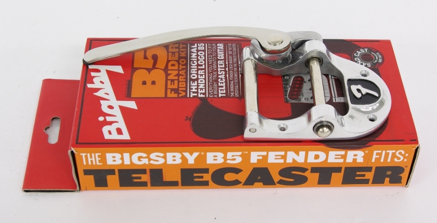

6 - I used the "Bigsby B5 Fender". Looks like this.
But a regular B5 would work just the same.

I have a Tele with a B5 as well. No special shenanigans are needed it you don’t use a TOM bridge. If you do , then yes an angled pocket or shims might be the call of the day.
