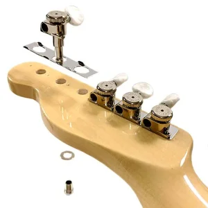

And ... if your worried about your drilling skills (and even if you're not) when it comes to tuners ... hipshot makes some handsome tuners if you aren't interested in drilling. I put them on all my projects. Look for the tuners with the ump plate. The tuning buttons can be swapped out for plastic and other shapes, so plenty of options.
Right-sized pilot holes, plus a little beeswax on the screw threads...
Another vote for the Hipshot UMP system: why drill if you don't have to?
