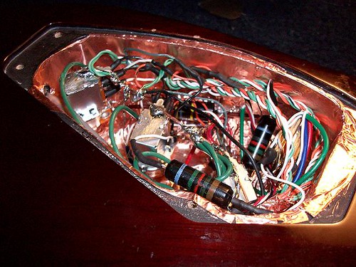

STDC has a really great system of grounding.  Mine is a little different, but simillar.  I use a piece of solid copper wire wrapped around one pot where it's securely held close to the copper tape shield. I then have that solid wire sweeping over the components where all ground wires can connect to the ground bus.  Checked with a ohm meter, I don't get a peep above 0.00 ohms on the meter between any ground connections.
More complication, more PCB, more expense, more things to go wrong, so that you don't have to solder to a volume pot? I don't get the appeal unless you really are new to electronics.
It's hard to see, but on this particular guitar the wire goes straight through the tape and the wire hole, and got soldered to the tape.  On a previous Strat build the wire goes south on the last pot, then it's bent around and locked between the nut, washers, and the copper tape.  It might not seem necessary to solder the wire to the tops of the switches, but I found no reliable continuity between the pot and the switch, as well as the solder points hold the wire tight and secure. The wire is actually the solid-copper, not copper-clad, center of some RG-6, I had laying around.  It keeps everything, nice and grounded as a copper wire that long has almost no DC resistance.
Firebird said:
Man I have no idea what's going on in that mess at all.
If I'm a happy 2- or 3-pickup + one volume + one tone sort of guy, should I just stop reading now?
Lol, this one only has two pickups, two volumes, and a tone control.  The push-pulls are one phase switch, and the other set act like a series/parallel/coil selector, similar two a P-rails configuration.  The other one, my strat, has many more switches and wiring than that.  That's the good thing about the ground wire, wherever the wire is at whatever length it's easy to find a place to attach it to the ground bus without having to bunch everything in one spot.  In that picture it's easier to see the copper wire, but the spaghetti incident was still getting cleaned up right up to the point when it was completed.  Everything works like a champ. :laughing7:  I just offered up the picture for Cracked Pepper to see what I was talking about. I should probably show the completed picture, but you can't see too much of where the connections are going.
