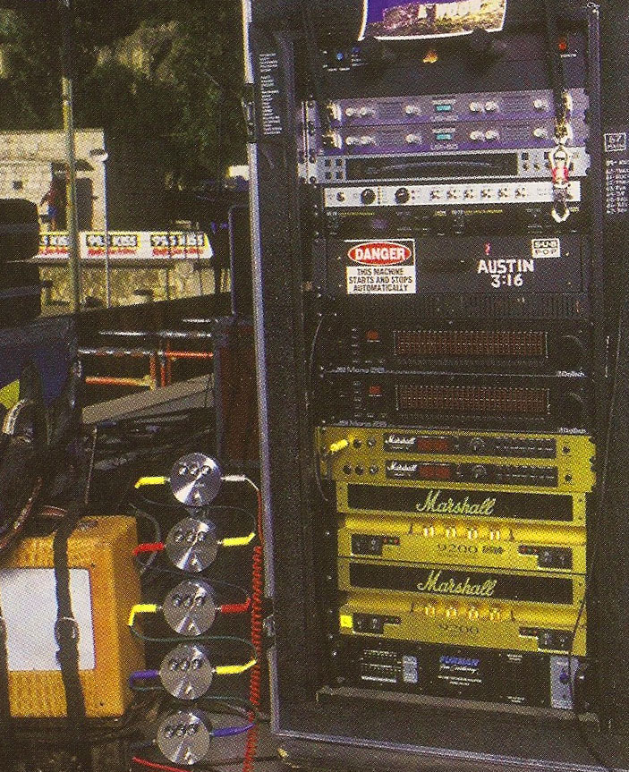

Here's what you need to get that Billy Gibbons tone:
Meaning, specifically, the small tweed amp in the lower left hand corner of that photo -- the rest is just there to put folks off the scent and to sell merchandise through endorsements.
