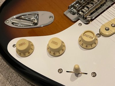

Do you sell the knobs with the push button? I see the push/push pots but not the push/push knobs. Maybe I’m not using the correct terminology. Here is a photo of my Strat with the kind of knob I’m looking for. The volume knob has a button in the center of the knob to press/depress.

So, a regular Fender knob will work with the push/push pots on the Warmoth site? How does that work since there is no button to push in the center of the knob?

What you’re asking about is the Fender S1 knob as noted. It only functions with the S1 pot.
A push/ push pot uses a std knob, and it doesn’t sit any higher. It’s a latching switch unlike a push/ pull pot.
Interesting. I just looked at all of my standard Strat knobs and they all sit practically flush on the pickguard with very little space between the underside of the knob and top of the pickguard. I’m extremely intrigued by the push/push knob if it looks exactly like a standard knob. I’m sold!
When it's pushed "in" to its standard position, your knob should be the same height as any other on your guitar (provided you use the washers and nuts to set it properly during install), but when you then Push it to engage whatever fancy wiring you've implemented, it does pop out an 1/8" or maybe 3/16" further from the surface. Same as Push-Pull pot, just without the pulling.
This makes sense. I figured there would have to be a change in height to engage or disengage the wiring. Thanks for clarifying!
