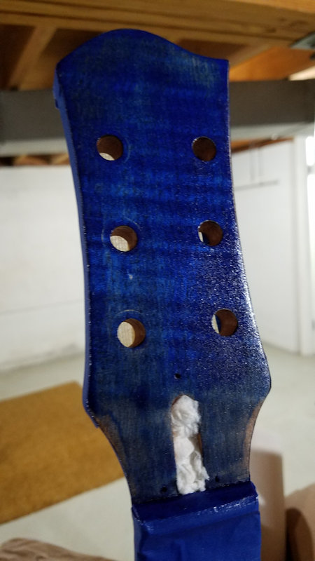

I don't know if it's the trick, but I was able to get this with TransTint blue:
It's barely diluted, though. Maybe 8:1 or 10:1 ratio of dye to water.  When I started with 4:1, it seemed like it hardly made a difference.
But I'm tempted to try the Fiebings on the next project.
