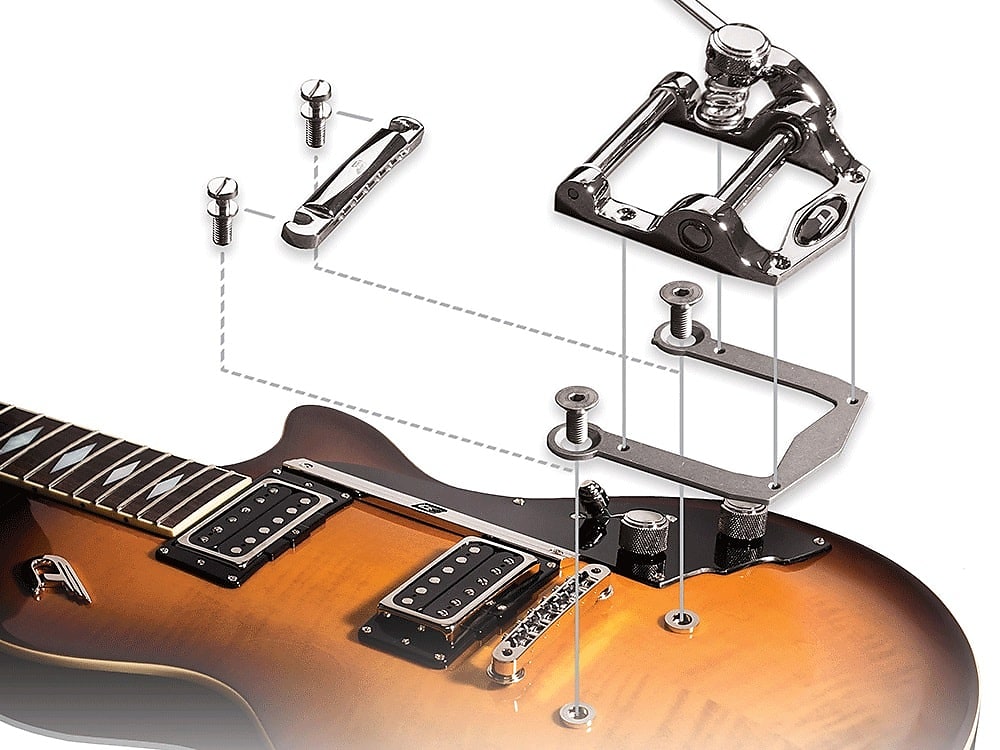

I’ve assembled quite a few Warmoth Strats but I plan to do my first Tele soon which will be a rear routed HH with TOM bridge and a Bigsby-like trem (Duesenberg Diamond Tremola) attached to the TOM tailpiece studs via this adapter.
My question is, how would I properly ground the strings for this kind of setup? I’m used to grounding to a trem claw or a hard tail Hipshot bridge which this setup obviously won’t have.

Usually a TOM is grounded through a hole to the bridge stud.
I finally got around to looking under the hood. Lo and behold, there is a wire that I would wager is that grounding wire to the TOM stud (?)
