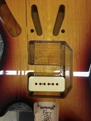

please help me i am trying to figure out
if p-90 pickups will fit into the universal routing
of warmoths mustang model
i know they do not offer p90 cuts on the pickguard
because of the traditional mustang switches
i plan on using a three way switch in between tone and volume control
so will a p-90 fit in a warmoth body mustang
please help !!!
The Wide of P90 is around same as the single Strat pickups.
So it  can fit in a warmoth body mustang .
only you need to select None cuts pickups hole on the pickguard , and DIY CUT it.

I ordered a pickguard one time with the neck pickup route cut but without the mounting holes on either end. Then I just opened up the route to fit the pickup and drilled the mounting holes where they needed to be. It requires a call to specially order but they were able to do it for me.
When I've had questions like this I've called Big-W and asked directly.  They'll tell you.  I've had pickguards that didn't fit the pups exactly and I've wound up sanding them a little to make them bigger (humbucker to trembucker situation).  And then I've had to take a dremel tool to make spaces bigger in the wood (control cavity).  It's all doable.
Hendrix said:
The Wide of P90 is around same as the single Strat pickups...
Not to split hairs, but that scratchplate builder pic is a bit misleading - the width of the (visible) part of a Strat pickup is about 2.75" and a P90 is about 3.35". They'd still probably fit though, with some risk of needing a little wood removing - as Rick said, nothing too problematic though.
It would certainly be worth calling Warmoth to ask if they'd cut the pickguard for P90s.

my main concern is if the p-90s will fit inside the 3.5 width of the universal warmoth mustang routeing
Another option for you are P90's in a humbucker form factor, that way you don't have to sweat it.  Phat Cat ... Rail Hammer are both excellent PUPs.
