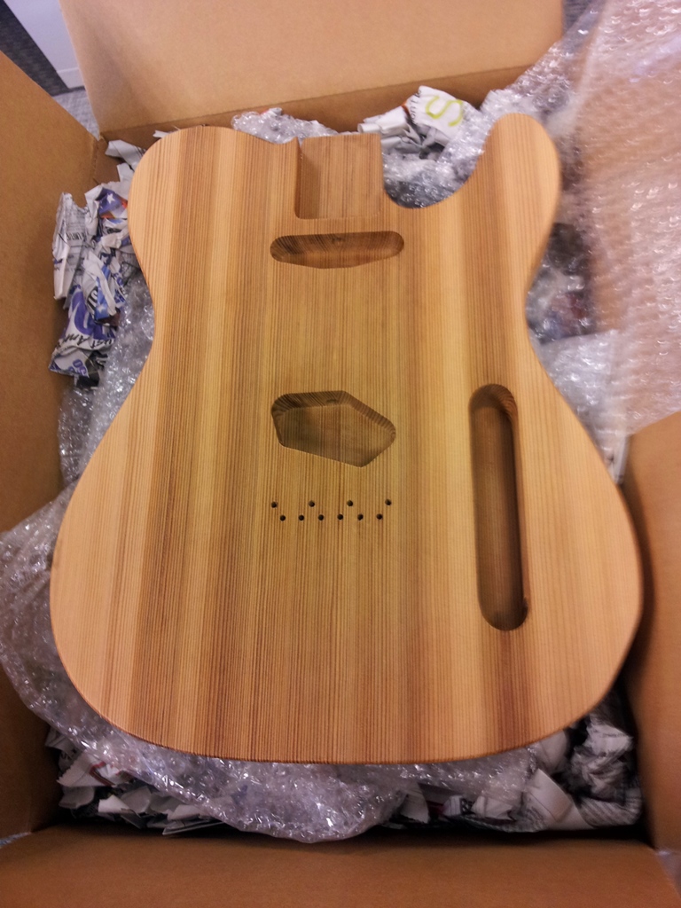

Submitted for your enjoyment, a Renegade Guitars body in western red cedar that I picked up for a song on the 'bay back in 2013.  The plan is to stain with yellow to give it a little more of an amber look, and then do a burst edge in brown.  With luck it'll be a fair approximation of something between a honey burst and a tobacco burst.  With a tortoise pickguard, chrome fiddly bits, the Quarter Pound bridge pup from Bete Noire, a Duncan Vintage Stack neck pickup, and a Warmoth boat-neck in wenge with stainless 6115's, it should be a pretty nice axe.

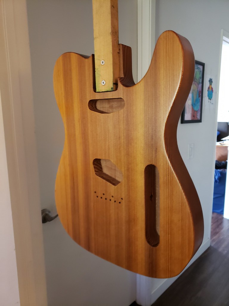

The photo above was shot under fluorescent light and has kind of a yucky greenish cast; the body's actually a warm, rosy pinkish tan.  This afternoon I hit the body with pre-stain conditioner and then Behlen lemon yellow dye to give it an amber cast, and I'm pretty happy with  it.

Looks great! I like the way the cedar colors up. You got just the right amount of stain on it. A brown burstover will look outstanding on that. You're certainly off to a fine start. :icon_thumright:

That piece of wood is super nice, the grain is so prominent. Will look awesome with the burst. The neck sounds meaty as well. Best of luck :rock-on:
Renegade Guitarworks stuff is well made, quality work. Matt and his dad offer some nice pieces. I own a few myself, and have assembled some projects for clients with his bodies. Good choice.
Great looking body! Can't wait to see how it turns out.

Beautiful grain on that body and the yellow really looks good. What brand conditioner did you use?

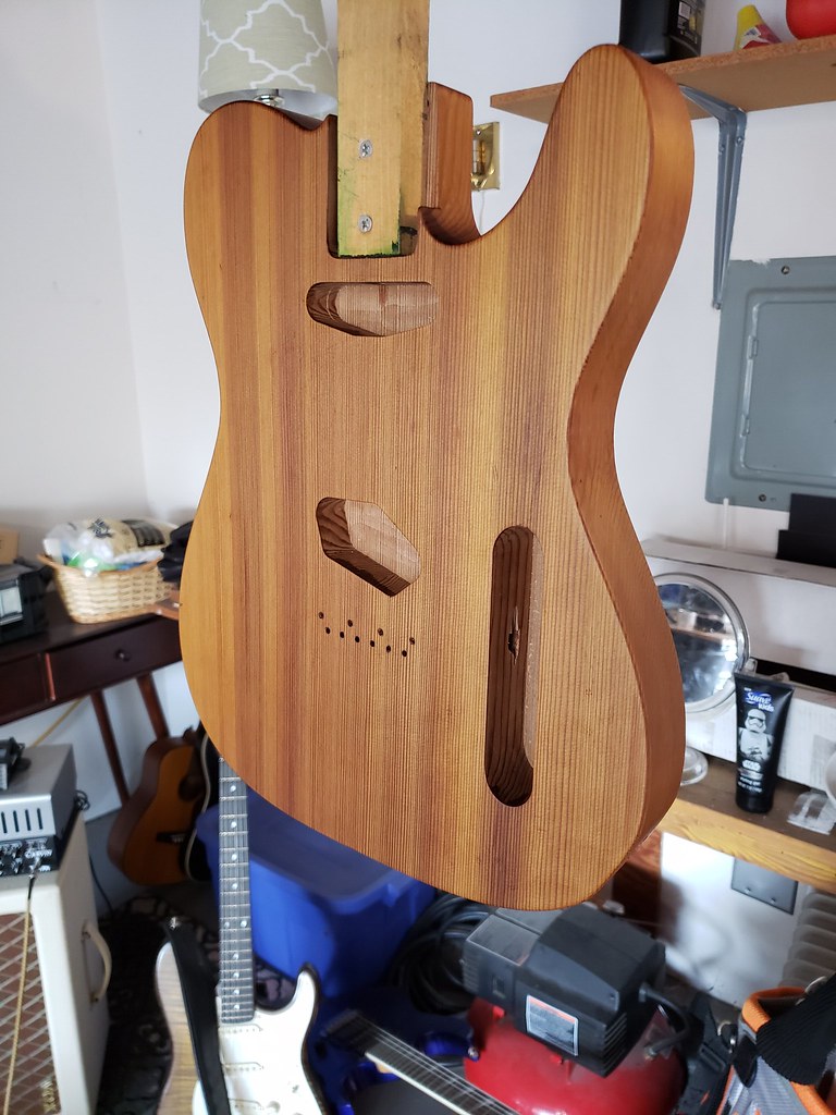

Well, the rain quit yesterday morning so I got a sealer coat of shellac on it before I start doing the lacquer burst.  Not much to show, but here's a photo for the masses in any event.
