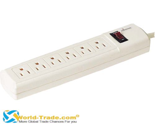

I'll look into these power conditioning strips( whatever they may be )
I just wasn't sure if you had a different guitar to try, or if you had similar problems where you are at before.  The guitar is the first place to look for a solution to the noise problem, but the environment can get to it to.  Trying your equipment somewhere else will tell you once and for all what the culprit is.  As far as the power conditioner, you don't have to go out and buy an expensive Furman unit, or at least I hope not.  You should be able to find a sensibly priced power strip with power conditoning capability/noise filter, but try the gear somewhere else first, after you have finished shielding the guitar.

Those "Surge protector power conditioning" strips have little to no effect on anything, as far as conditioning goes. If they did, they'd cost many hundreds of dollars, not front pocket money, and they'd  weigh as much or more than your amp. Their greatest utility is the fact that you get several outlets out of one outlet and it's switched. There's often a circuit breaker built in to protect the circuit breaker at the distribution panel (pointless). The "power conditioning" is usually nothing more than an MOV and a little DvDt circuit across the primary feed, which is generally a lot less than what is already built into the power supply of the device you're trying to protect.
So, it's not that the things are useless - we all need multiple outlets to hook up a variety of things, so by all means get one of the little buggers - but the "conditioning" part of the sales pitch is a marketing ploy. Means nothing. Even the Furmans that cost $150 and up don't do anything special outside of some convenient packaging that sometimes includes a voltage readout and some lights.
I would hope you wouldn't wind up using something like a Furman.  At work, they aren't useless, they do power sequencing and control.  The power conditioning side is just one form of protection from power surges and fluctuations, or something that will blow up before the equipment.  Radio shack has, or at least used to have RF noise suppressors for power outlets.  I don't think your TV is the problem, but does noise come through the speakers too?  I hope this isn't the case for you at all, but I have run into so many funky instances of noise for things other than the guitar that required filtering or some form of isolation, and that took care of it.  I hate to send you anywhere else to buy more crap, but you can purchase one of those lighted plug outlet indicators that you can move around from plug to plug to verify if the outlets are grounded in your home.  Those are pretty cheap.  Of course do all of the other stuff first before you come to this point.  My amp already has a noise gate in it, but check out stuff like this too: http://guitars.musiciansfriend.com/product/Ebtech-Hum-X-Hum-Exterminator?sku=150452  that seems better, but similar to what Radioshack used to have.
Every one KNOWS the Brown surge protectors have better tone, and white ones sound like chicken farts

:laughing3:  And they let out smoke all the same when they stop working.
