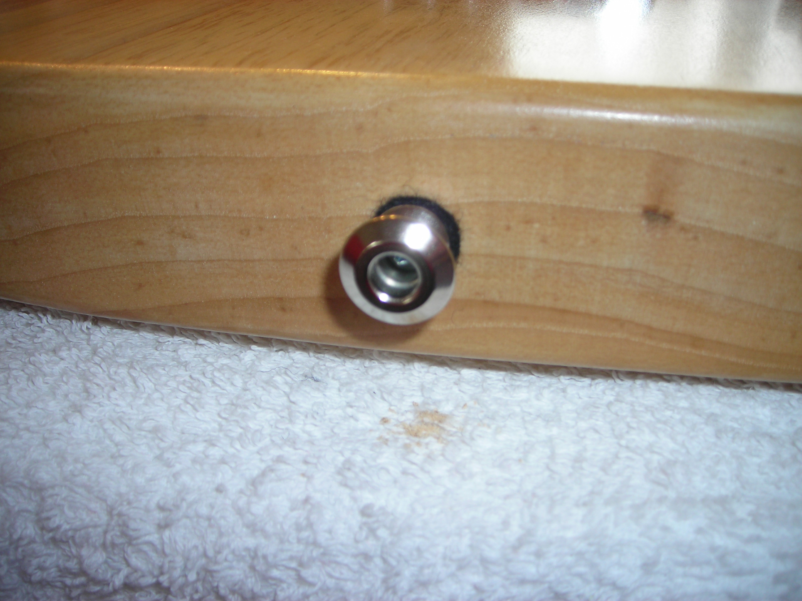

Thanks, I just wanted to give the electro socket a try. Worse case if I don't like it in the long run I'll put a square or football one on.
I just checked on an old Squier Tele body I have and that has a square plate.
What's the beef with the elctro? I always thought it looked like a cool invention. First I've heard of any downsides.
Electrosocket works great on vintage-style tele bodies, since the body flattens out where the jack hole is cut; but the electro does not fit as snugly as you'd like with the modern rounded-off body.  Other than that, I think it's an attractive part, and I've used them on a couple builds.
Yes that's what I found it's not quite a snug fit, so I think Bagman67 has hit the nail on the head.
The electro socket is certainly functional however.
It is as Bagman says - the thing doesn't really fit on modern bodies. But, what really grinds me is the thing is designed to funnel the plug into the jack so you have faster/easier cord plug-ins. But if you install the jack so that the funnelling feature works, you have to be careful what cords you use. Actually, it's not the cords - it's the plug design. If it has a squared-off shoulder, the plug doesn't want to go all the way in as it hits on the sloped sides of the Electrosocket. It'll feel like it's there, but then the plug falls out at inopportune times. Some plugs work, as their shoulders are rounded off, but who pays attention to that sort of thing?
The thing to do if you want to mitigate that is to install the jack so it protrudes out the center of the Electrosocket, but then you lose the funnelling feature.
I know I'm being petty; it's just a pet peeve of mine. It is an attractive mount. But, to me it fails in practice so it's unacceptable. I never want to fight with an instrument.

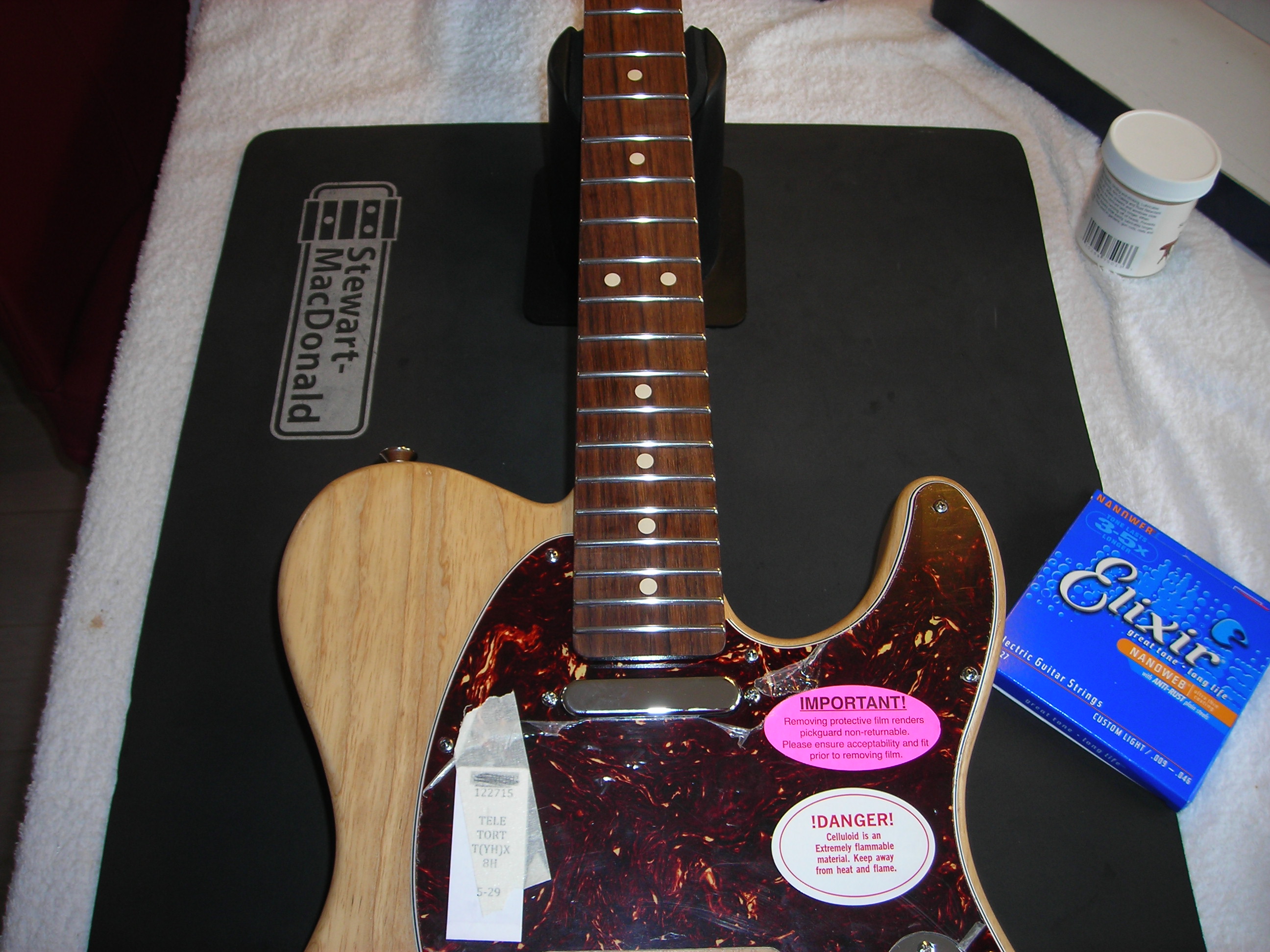

Final Assembly.

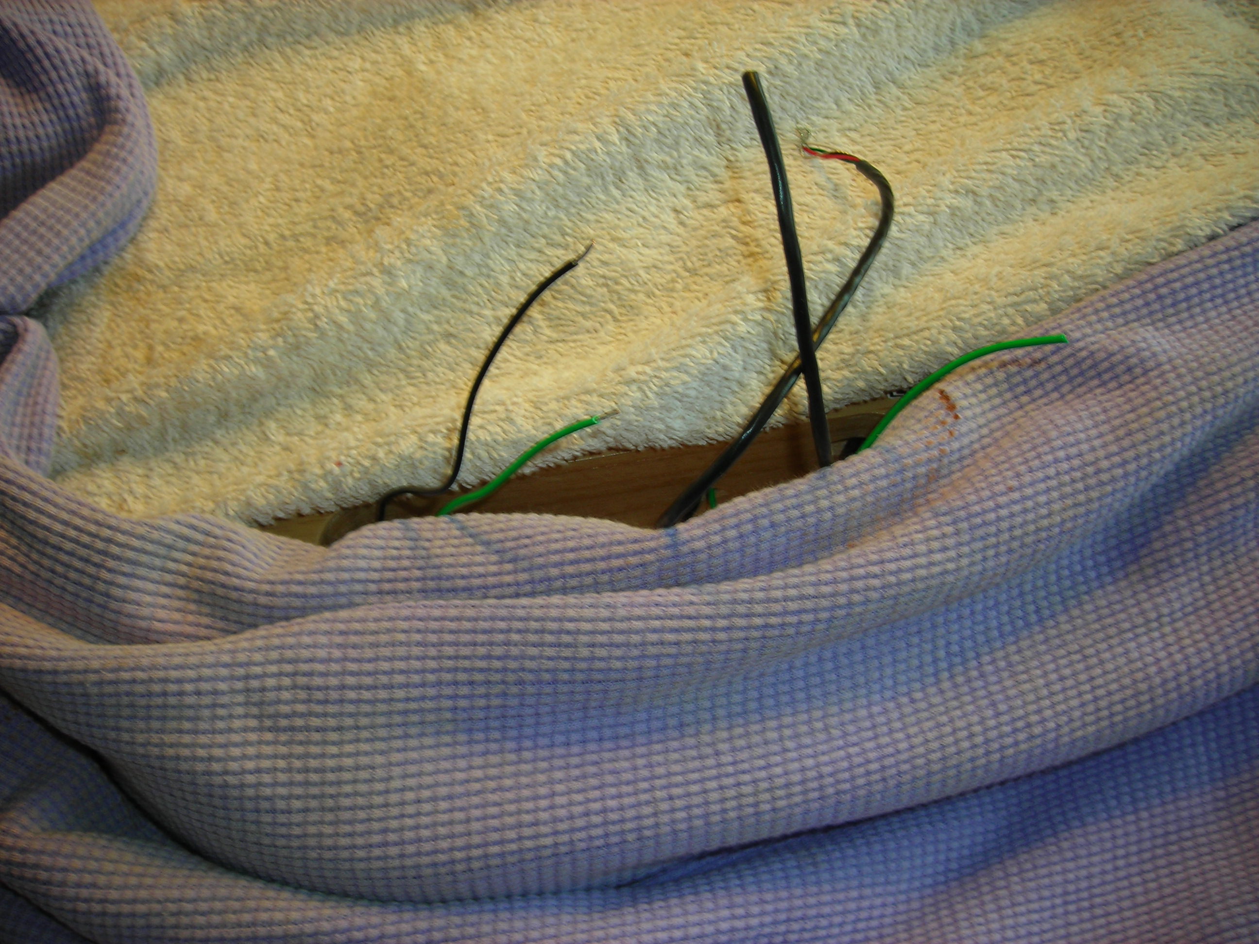

Body protected ready for soldering the pickups, ground wire and output jack to the prepared control plate.
Assembly_23 by stratamania, on Flickr
Soldering completed.
Assembly_25 by stratamania, on Flickr

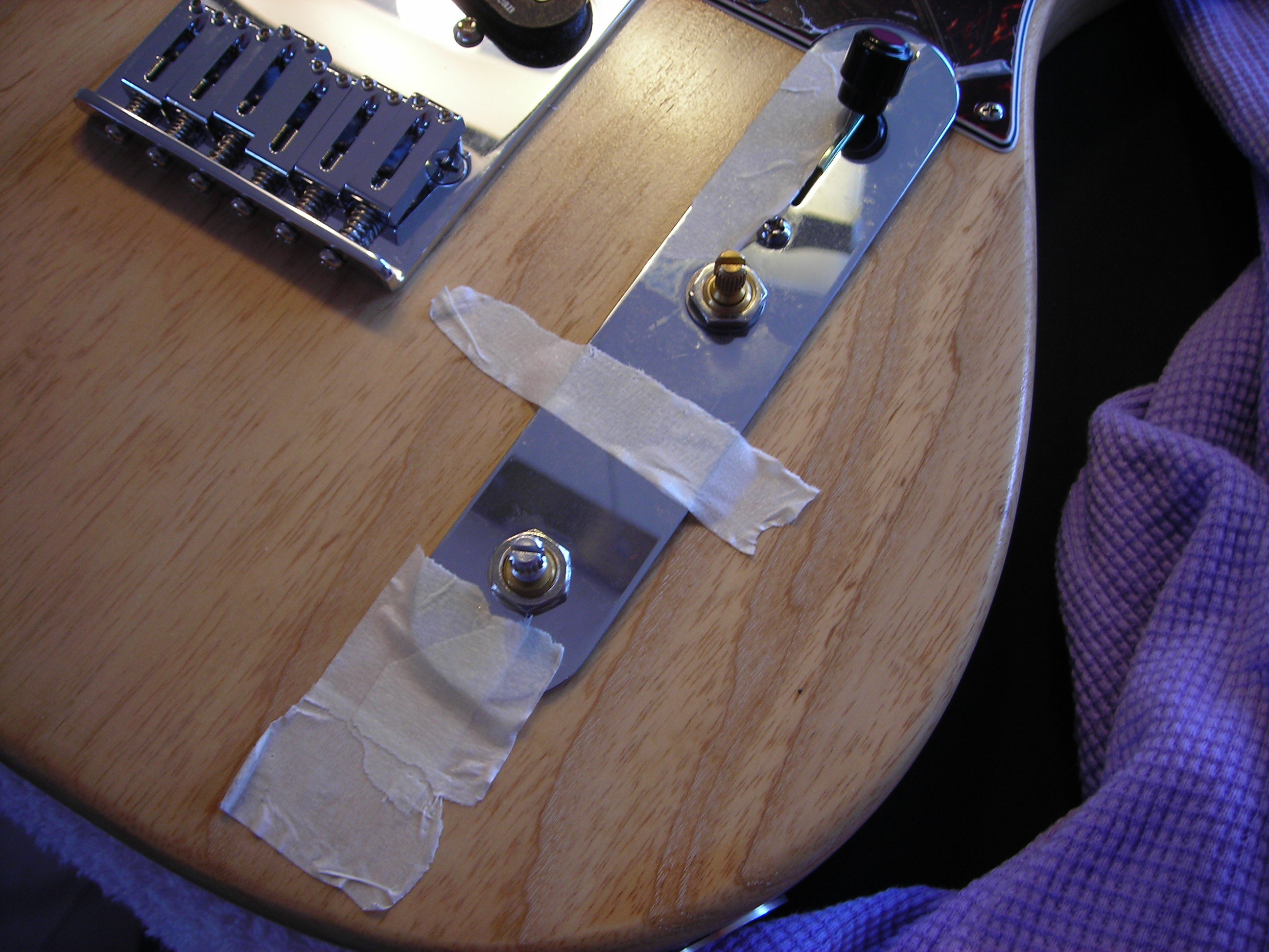

Control plate taped into position.
Assembly_26 by stratamania, on Flickr
After plugging into an amp and tap testing the pickups and volume and tone all seemed well which is a relief after doing the wiring.

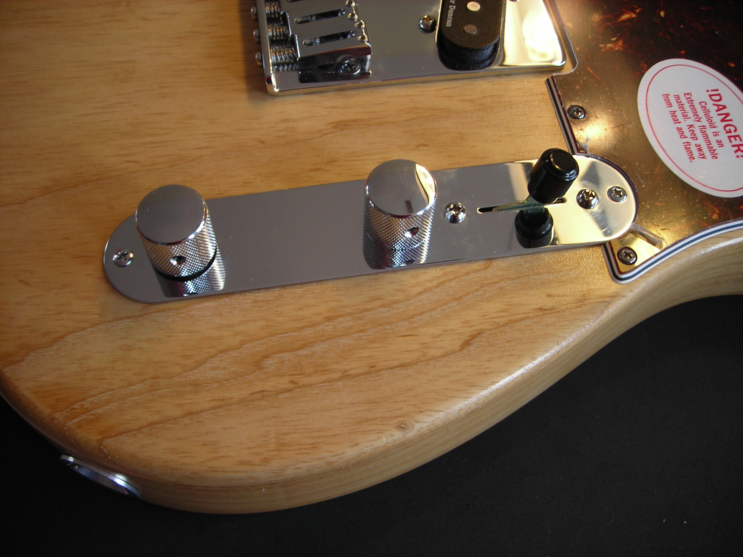

Control plate fixed in position.
Assembly_27 by stratamania, on Flickr
