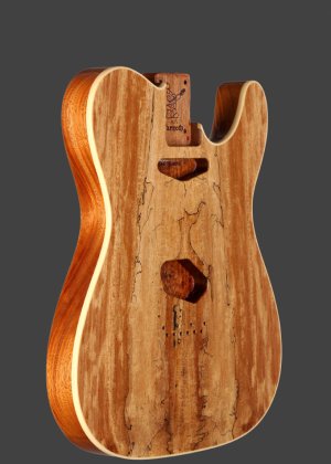

Well guys, just placed an order for a showcase Telecaster neck and body from Warmoth.
The body is a spalted maple top with a mahogany body and ivory top binding. I wanted a swamp ash body, but I figured Mahogany shouldn't make much of a difference. The finish is a clear gloss finish on the front and back.
The neck is a showcase modern roasted flame maple neck with a fatback neck profile with a clear satin finish.
It will have Schaller mini locking tuners in black, with a black nut, black Gotoh Telecaster bridge, Black round top knobs, no pick guard or control plate, and Fender Custom Shop '51 NOcaster pickups.
The end result should be pretty cool I think!

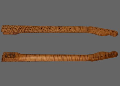

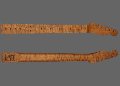

Oops, wrong photo of the neck. Here's the actual neck I ordered:
Very nice body. I think I can see where the treasure is buried.
And the neck is absolutely outstanding. Wow!
