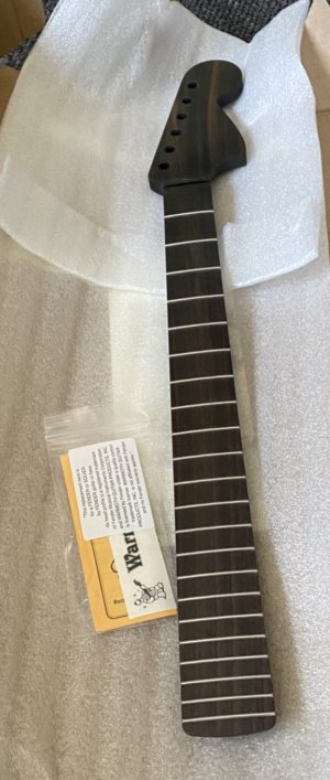

1)A Vintage modern 1 piece Indian Rosewood neck 59 roundback 22 frets no inlays side marker mother of pearl 6150ss frets

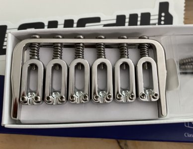

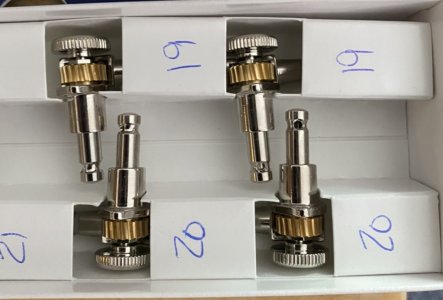

Went with Hipshot Flat mount bridge and openback locking tuners in nickel.

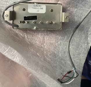

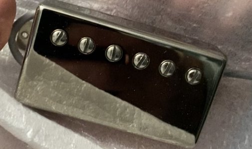

For pickups i have
Gibson Classic 57+Bridge Classic 57 neck 4 conductors

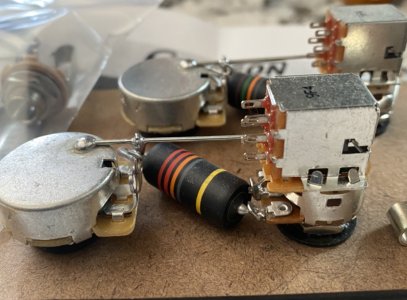

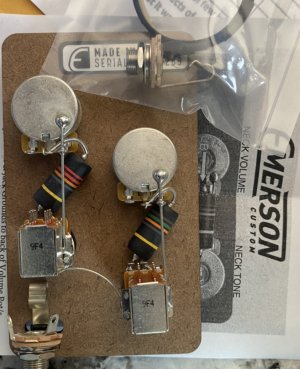

Electronics are From Emerson prewired

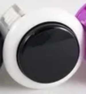

Cts 500k push pull with bumble bee capacitors and 50’s wiring.switch craft 3way switch. Have 2 Tesi Kill switches but may only put in one depending if my electronics harness can do what i want when done

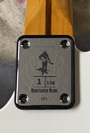

Have a custom neck plate made will update as some parts come in but i am few months out on body neck maybe 3 more weeks

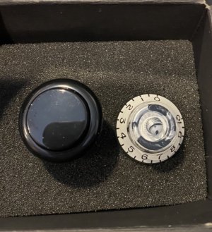

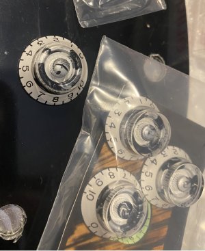

I love the clear/white gibson knobs.
The Hipshot bridge is great and super comfy.
Watch out for the saddles. My strat has one from 2009/10. The 9s I use actually wore a groove in the high e saddle. Not bad, but just enough to click and make sitar sounds.
A bit of sand paper solved it twice.
I'm not sure if the saddles are any harder in newer versions.

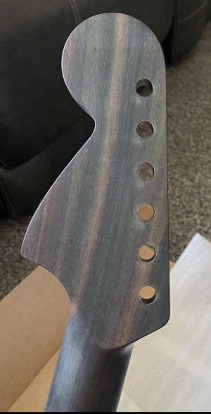

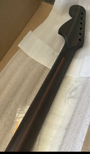

Neck has shipped! Ordered on august 8 shipped sept 7 raw indian rosewood
