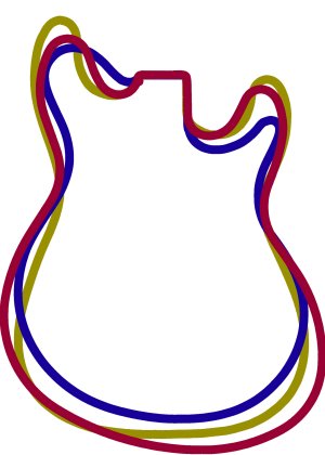

I made this graphic awhile ago from RAW photos taken by the photography department. The Red is a Mooncaster, the Blue is a Velocity, and the Yellow is a Strat. Maybe it will help.
Very helpful.....thanks!
ragamuffin said:
Wow, it's definitely smaller than I imagined!
Agree.  Looks like they are generally the same size with some dimensional shifts.  I've briefly played a StarCaster at GC, and the body was noticeably bigger.

Yep...the Mooncaster body is quite a bit smaller than a Starcaster.
