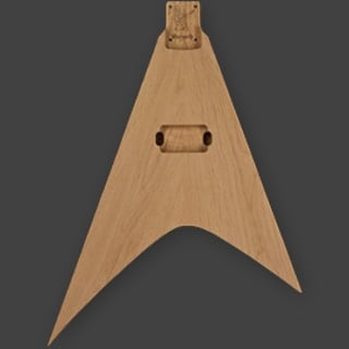

Having said that, if you don't want to go that route, the Velocity body has pretty awesome upper fret access, so you could probably get away with a 24 fret extension on that. V bodies always work. Those would be the ones I would look at personally.

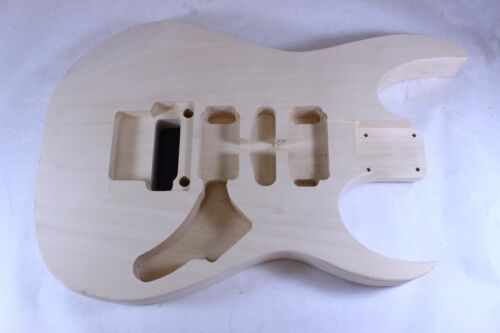

Second, you might be able to attach a Warmoth 24-fret neck to an Ibanez body, something with the square (OSNJ) neck heel like they still offer on the RG550:
I can't confirm this works because I haven't tried it, but I suspect it will because (a) a standard strat neck will fit only many older Ibanez electrics with the square heel, at least those with 22 frets (I've got a JS1200 body with a Warmoth mooncaster neck on it; I reshaped the headstock to look more like an Ibanez), (b) when Ibanez first introduced 24 fret necks, it sure looks like they just added an extension on the fretboard and didn't change the routing of the neck pocket (which was still 56mm wide), and (c) just eyeballing it from pics, it looks like the neck screws align near the correct frets. I'll bet someone at Warmoth knows whether this would work, they must have been asked about this before. If it does work, you can either find a used Ibanez body online or have one made--Serge Fidar, Five Alarm Guitars, probably others will CNC one quite affordably, and you can choose a lot of specs. Either way, just make sure it's got the square OSNJ neck heel, for a 56mm neck. More modern Ibanez guitars typically use the AANJ neck heel with a 58mm neck. Those who make bodies can do the neck heel either way, and you could get the body shape of an RG, S, JS, JEM, PIA, and many more, with whatever pickup and bridge routes you like.
Here's what an unfinished RG body llooks like with the OSNJ 56mm neck heel. As I say, it sure looks like a Warmoth 24 fret neck would fit right on there...
