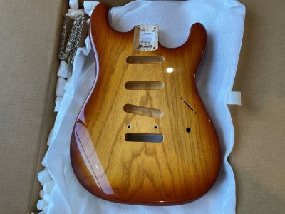

A bit more than a year ago I bought this beautiful swamp ash body attached below.
It was a one-piece showcase ash body I selected the paint option.

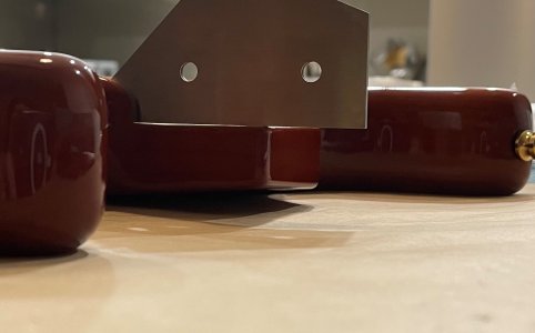

I have a neck for it and had bought all the hardware ready to go. Installed tuners on the neck and tested the fit, unfortunately, there was a gap on the side of the neck fit. After further inspection, I figured out that the pocket had a slight curve on one side and the front (attached also.)
The curve is not that much, but the gap is visible when the neck is installed. So I debated what to do with it for a couple of weeks and decided to keep it and fix it. The neck pocket is high enough that could be taken down 1-1.5mm with no issue.

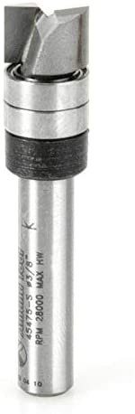

It has been sitting around waiting for me to fix it, and I finally got a router bit and template to start. Here are the tools I got:
Makita compact router (https://www.makitatools.com/products/details/RT0701C)
Amana tool carbide tipped top bearing router bit - 3/8" diameter, the cutting part is 1/4" so the bearings would roll on the neck pocket cavity wall
Stew mac strat neck pocket template
Here's what I plan to do:
I noticed the stewmac template is a bit different to the warmoth neck pocket shape, but that doesn't matter as I just use it under router base and use cavity walls as guide for the bit. I put the template on top and lower the cavity floor by 1mm leveling it.

I’m still trying to figure out how a depth measurement changes a width parameter.
You specified a
Side is not bottom.
Considering that the high spot is the open corner, I'd suggest sandpaper and a block too. Or, a good flat file. I think you might find that you don't have to remove as much material as first thought............ :headbang:

But adding the filler and sanding back won't change the depth of the pocket....
I guess I am not interpreting the pics correctly. I thought he had a very small low spot on one edge of the pocket. Just thought that a thin 1/4 inch wide piece of wood and glue would raise it and then could be sanded down to blend/level. Maybe not.
I reckon it will not require much sanding to level it.
There is some finish build up at the outer facing parts of the pocket which in themselves are probably causing the level to show light through it. Obviously I can only see what I can see from the photos but it does not look very much that the wood itself is uneven.
I always clean up any finish residue from a neck pocket as a matter of course.
I hadn't noticed that until re-looking at first pic. that along with the pic of the triangle edge, it's quite possible it is just finish overlap. So I would agree, it's worth sanding the pocket free of any finish overlap before any drastic routing...
