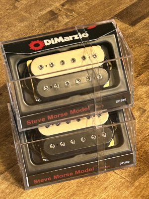

Well, I've got enough guitars with PAF-style humbuckers that I'm not exactly chasing something vintage here. I also don't really have an idea for the switchable pot, but I may run it as a coil split with a variable resistor trimpot between the split coil and ground so I can balance out a partial split that will sound nice in all three positions. To that end I'm looking at medium ish output balanced set so that the pots still see a pretty high DCR from the leftover coils.
Or, I may fulfill another lifelong dream of mine and finally buy the DiMarzio Morse set. Steve Morse is a HUGE influence of mine, but the weird specs on those has always made me a bit hesitant.
