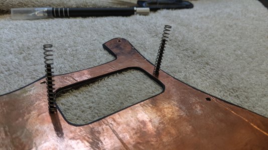

So did I buy the wrong size screw or spring to mount these humbuckers?

A lot of times the springs come like that. You can snip them shorter with a pair of wire snippers or flush cutter, etc.

Thanks. Guess I'll experiment a bit.
They're springs; they compress. Just put the pickups on.
You also get to play a fun game of find the spring when you inevitably shoot one across the room.
On a slightly more serious note, don't cut them too short or their functionality will suffer.
Just compress them. It’s not they are 30lb springs.
A cheat: grab a fork. Slide the fork ( middle space between the tines ) between say coil 4 and 5 (whatever works best for you) and now you have a single handed tool to not only pre-compress the spring, but also can direct it to align. Also no shooting springs to chase down.
Thank me later LOL
