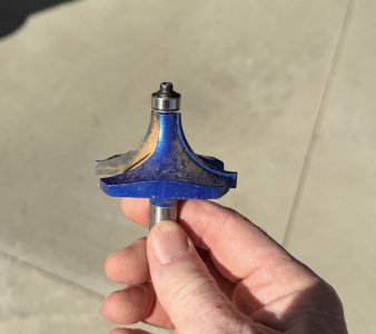

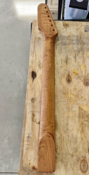

Did my first neck carving this weekend. Started with a gigantic round over bit on the routing table. That got me about 1/2 the way there and more importantly did a great job with the shoulders all the way to the fretboard. The rest I did with rasps, files, sanding. All in all, it took me about 4 hours of work to carve the neck and another hour or so of sanding.

Terrific idea on using a router bit for the initial carve.
