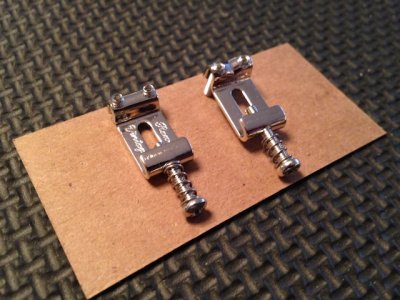

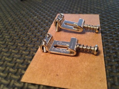

Regarding the bridge on my project, I went to a local guitar shop and they had the "raw vintage" saddles in stock. So, since I have a little hangup on the "vintage" look, and they had it in stock, and I did not want to wait two more weeks to get a bridge shipped from the US.  I bought a set and "upgraded" the saddles on the Warmoth bridge.
I don't know if this actually will be any better than the Hipshot but I will give it a try. (And I actually don't know if it's "upgrading" anything as well, but the guy in the store convinced me that the raw vintage saddles was nice... :) )
Heres some pictures on the difference from the raw vintage saddles to the warmoth saddles.
