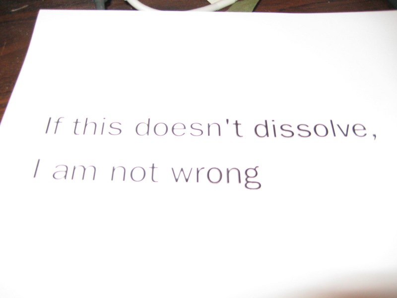

Put a coat or two of shellac sealer on before the lacquer.  The solvent in the lacquer will dissolve the laser printer ink.  There is a reason I know this.  I like that laser etch paisley.  Crap, I have enough things to get done.
Patrick
You're thinking of inkjet prints. Laser printers don't use ink. It's toner, which is micro-fine plastic powder that's heat-bonded to the print medium. It doesn't dissolve or run or fade. It's a fundamental requirement of the technology, since it relies on static electricity to form the image on the print drum. Ink wouldn't work.
We have had this argument before Cagey.  The solvents in the lacquer dissolve the laser toner.  Try it, don't believe me.  Or, look it up in the forum with the search function.  It does dissolve.  Print out a page with, "If this doesn't dissolve, I am not wrong." and then paint lacquer over it with a brush.
The flaw in your logic is that because it doesn't use solvents in the printing technology, it is not susceptible to solvents.  Not so.
Patrick
Ok.
I have to admit, though, that while you can't see it because of the over-exposure, there's a slight streaking of the type. Also, that's with pure acetone, not thinned lacquer. So, I'd say we're both right. You can dissolve toner if you work at it hard enough, but it's probably not going to be an issue shooting lacquer over a decal. I've not done it yet myself, but I have seen it done by others.
