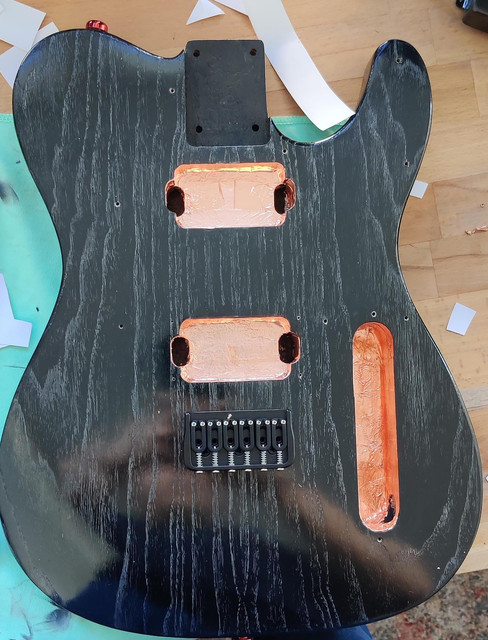

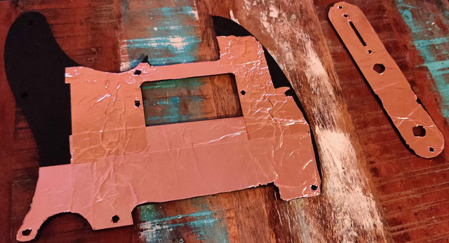

2. Copper Shielding: Not REALLY necessary for EMGs but better safe than sorry. The scratch plate looks like it's been done sloppy - but it does the job.

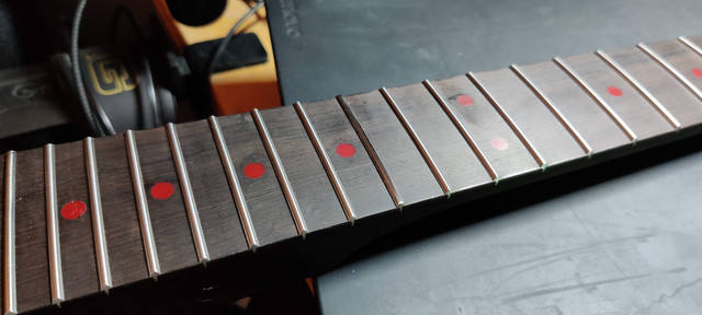

3. Fret Leveling: : I did one fret that wasn't level - can you spot which one? ;-)

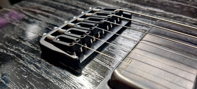

6. Adjustments: Installed bridge and intonated guitar (God, I love the aesthetics of Hipshot Contours):

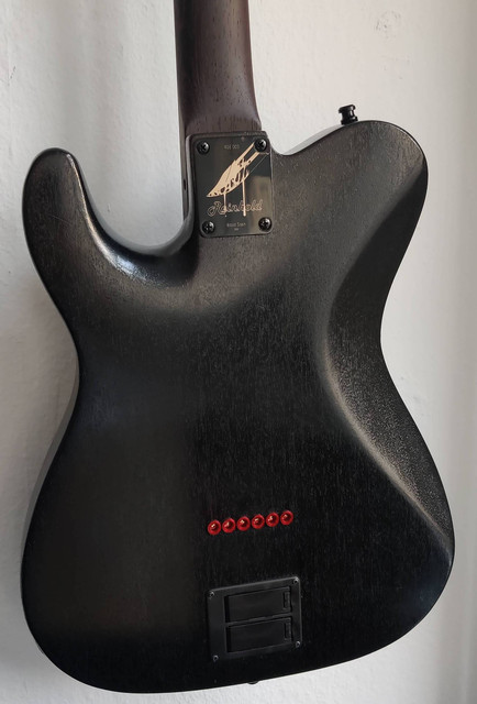

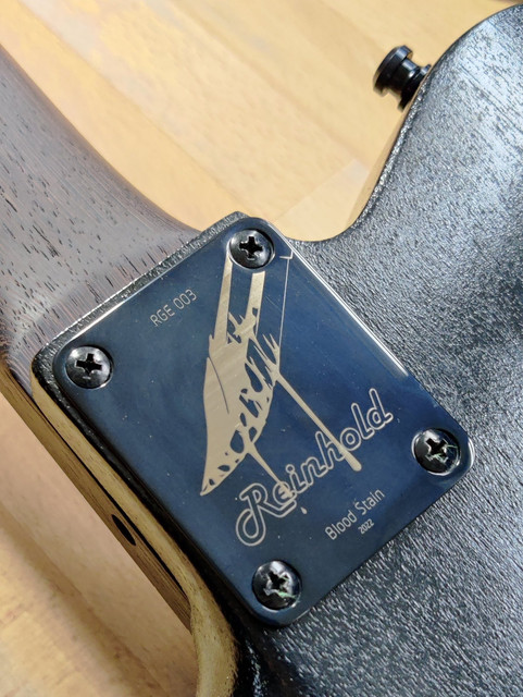

8. Strap Pins and Neck plate: Decided that I hate the red strap pins (see some pictures before) and replaced them by black Schaller S-Locks. Also installed my neck plate:

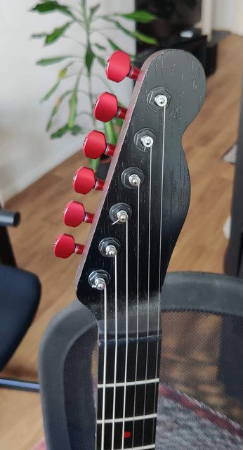

9. Tuners: Installed Sperzel locking tuners, but they came with silver bushings - had to reorder black bushings for 50€. Still waiting for them to arrive. Will post a pic once they are here.

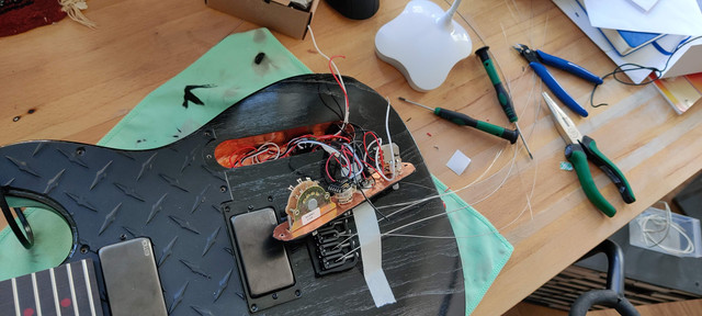

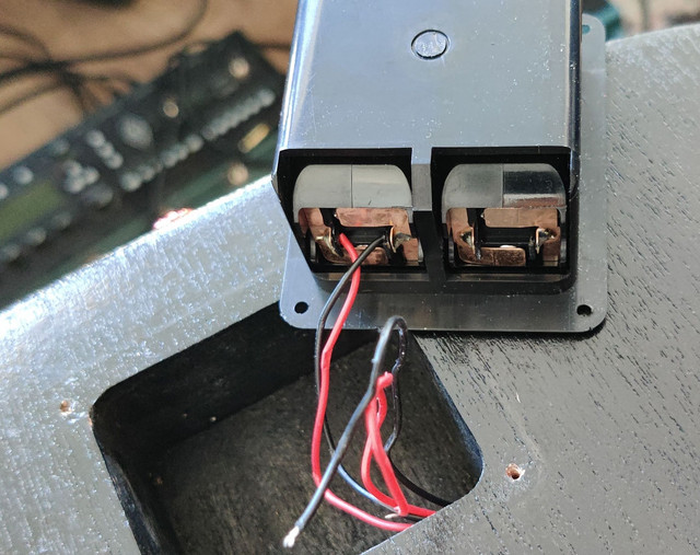

10. Wiring: Did the wiring and ran into several problems (see here: https://www.unofficialwarmoth.com/index.php?topic=33993.0). The overall idea is to do a proper metal setup - i.e. EMG 81/60. Also I liked the idea of adding a low battery indicator (although I might never need it). Moreover, for the heck of it, I also wanted to add a push/pull for the 18V mod. But to avoid complexity (and nonsense), I eventually decided against the push/pull. Still, the wiring turned out to be tricky because things just didn't work - until.... I found that the wires of the battery box had been disconnected all along. My general steps for wiring were:
- drill a hole into the cavity cover for the battery indicator (will post photo when I share the final guitar later in this thread)
- do the wiring diagram. It wasn't easy because I had to combine the EMG solderless system with soldering. Soldering had to be added because
  a) I used a blade switch instead of a toggle switch
  b) I used a Low Battery Indicator (so I had to splice cables and join them)
  c) I used the 18V mod (though I actually found a non-soldered way by just buying a battery connector from Home Depot)
- solder and fit everything into the cavity (man, Tele cavities are very small...)
- fix the battery box
11. Mounting: pickup ring for bridge pickup, screwing in pickguard, tightening all screws, etc.

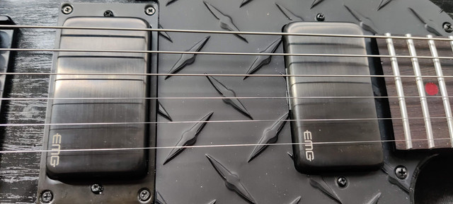

Also, I gotta say, I love the brushed black chrome EMGs, here's a close up:

First of all, I lubed the sharp ends of the guitar, installed the tuners and applied lemon oil to the fretboard. Now, two updates - a beautiful one (in my opinion) and a frustrating one.

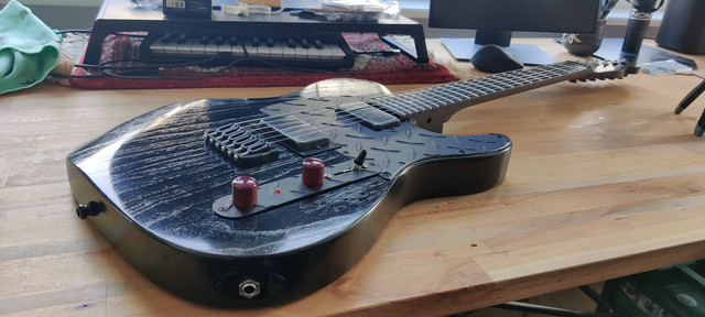

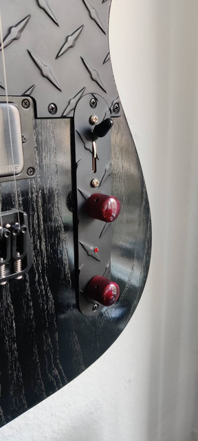

Let's start with the beautiful one. I installed my volume/tone knobs which I got from Xentric:
This leaves me with a completed body  :blob7:

Oh, and here is the headstock with the tuners (I love it):

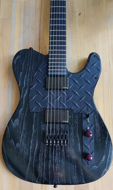

The guitar - which I have lovingly called "Blood Stain" is done. Below are some pics taken with my phone. I have also added a thread here: https://www.unofficialwarmoth.com/index.php?topic=34052.msg470760#msg470760
Front:
TRVE:
Back:
Headstock:
