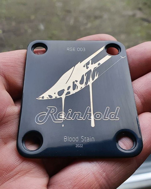

1. my neck plate from TLC Guitar Goods is ready and I really like it :-)

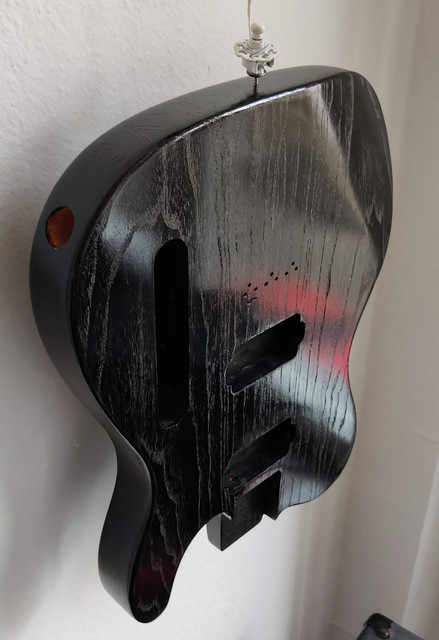

2. I am a couple of coats into the Tru-Oil treatment and it looks promising:
While gloss is always nice, it does not fit the character of the guitar. I am now considering whether to use BC Sheen and Conditioner for a Satin finish or use 0000 steel wool for a matte finish. Does anyone have experience with the latter and any best practices to share?

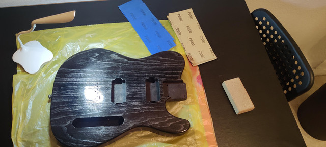

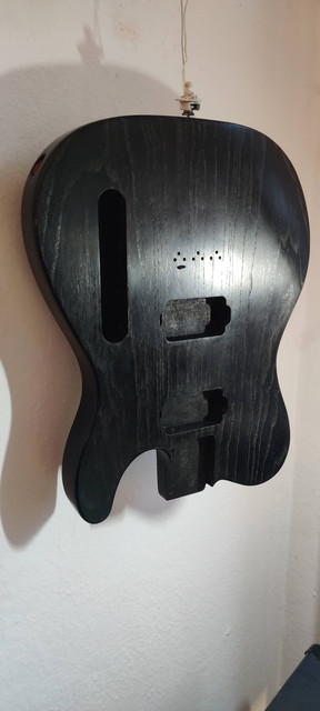

I let the tru-oil (10 coats) dry for a week. Then I sanded down to 2500 and applied BC Sheen and Conditioner. This created great deal of visible orange peel. So I just spent ~2 hours sanding down from 1200 to 2500. Overall, this worked fine wrt orange peel but got me to a much more subtle doghair look. I've got to be honest, I'm kinda missing popped out doghair with the shine - however, it is not what I had in mind with the guitar in the first place. Curious to hear which look you guys find better (pictures below).

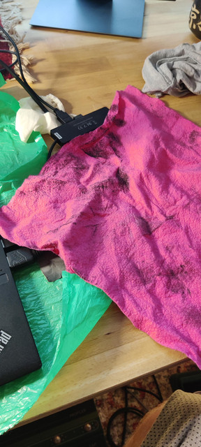

But here's the problem (or is it?). When sanding, I apparently went through the tru-oil on some spots. First I noticed, my fingers getting black. Later, when I buffed with a cloth, it became more than obvious. Now I did get to exactly the look that I wanted - however, after having sanded through some small spots on the guitar, will the guitar still be protected sufficiently or is it more advisable to hit it with another coat of tru-oil - or even start the entire process from scratch?
Before sanding:
After sanding and with BC Sheen and Conditioner:
Buff cloth:
