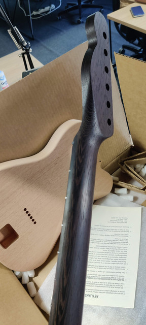

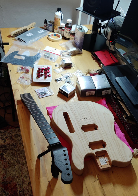

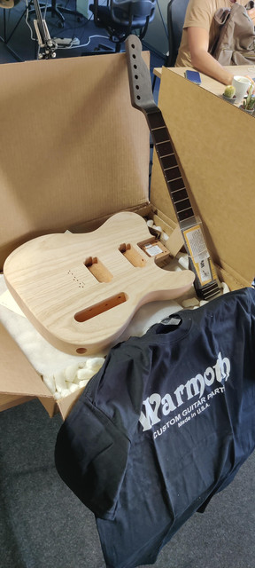

So... for a long time I've been heaving a vision to build a raw, heavy straight-forward metal guitar. My idea was to create a character that looks as distorted yet as tight as the sound it creates. I'm thinking Rectifier/EMG. So the obvious choice was a mahogany body. For the raw look I chose a swamp ash lam top. Given that the overall color theme is black and I love raw/unfinished necks, I got a wenge shaft with and to top up the metal character - of course - an ebony fretboard. Here's an out-of-the-box:
Here are most parts together:
And here a close-up of the neck:

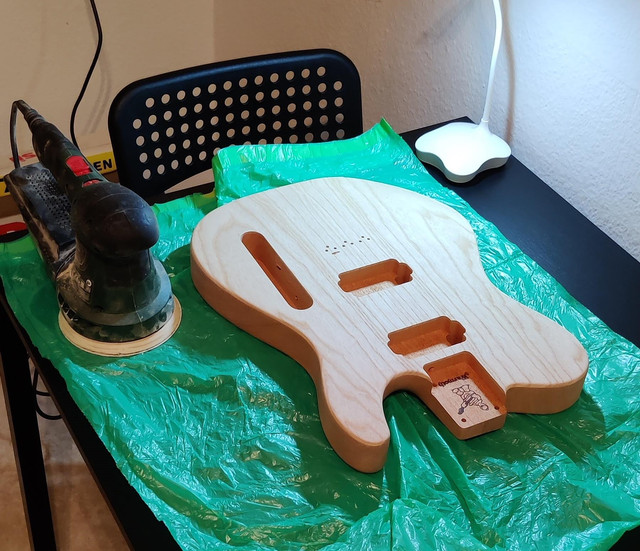

First step, sanding...

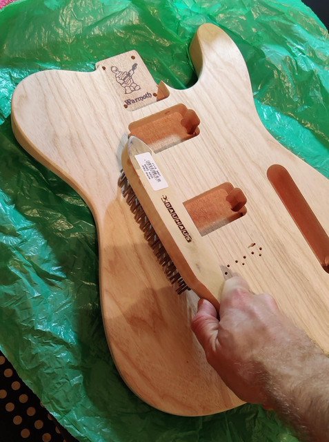

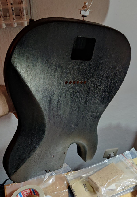

I am planning to paint the body and the headstock black and apply a ceruse/doghair to the swamp ash top. Having tried TONS of combinations before (damn, I tried things for months and am still not sure), I decided to go for india ink as base, sealer, lacquer for grain filling (weird, but let's see) and tru-oil. In order to make sure the lacquer stays, I need to do some unorthodox stuff that fits the rawness of the project. I am sanding down to no more than 240 (hence an orbital sander works just fine, however, I hand-sanded the sides):
I sanded three times and in between i used a wet cloth to raise the grain. Afterwards I used a metal brush to REALLY open the grain

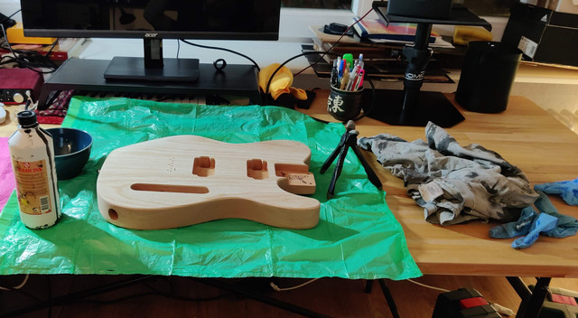

on to the first coat of india ink. Compared to all my test pieces (random blanks of ash), this guitar is damn thirsty. It's virtually been sucking in the india ink. Let's see how it behaves after 2-3 coats...
The first coat looks actually quite impressive on the swamp ash. I also like the mahogany. Let's see how it'll evolve over the next few days.

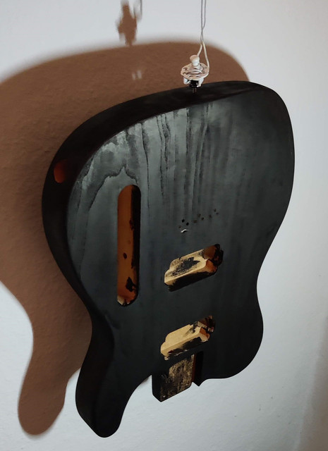

alright, I had some adventurous days with my guitar but I think things turned out solid.

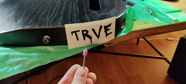

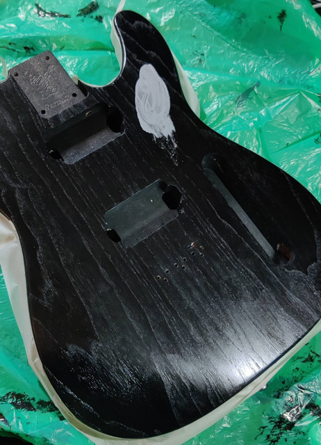

First I decided to add a little gimmick between the strap lock and the tuner hole (more or less as a barely visible joke):
What I did here was mix red ink, wood putty and sealer and apply it with a cloth. It looks disgusting by itself but kinda cool on the black. I was very scared that it wouldn't survive my steel wool / extra sealer treatment but it did (see below).

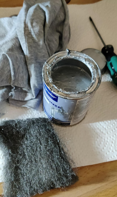

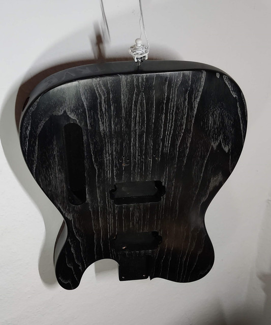

Then I put on sealer which already made the grain pop a bit. I waited 24 hours and then I went full on with lacquer and steel wool (man, was I scared). This were my tools:

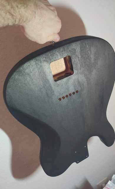

And that's the mess I created all over the guitar eventually:

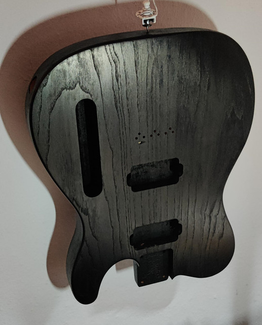

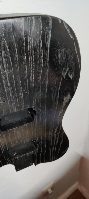

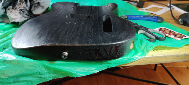

Then I hit it with 000 steel wool and - although not instructed - polished it with a cloth. Here's the result (mind, no tru oil yet):
After the buffing, it's very smooth so I might sand tomorrow where the pickguard will be to see it won't do any harm. If it does, straight tru-oil. If not, I might give it a light sand with 800 grit and then hit it with 10 coats of tru-oil. I'll post another picture after the first coat tomorrow.
