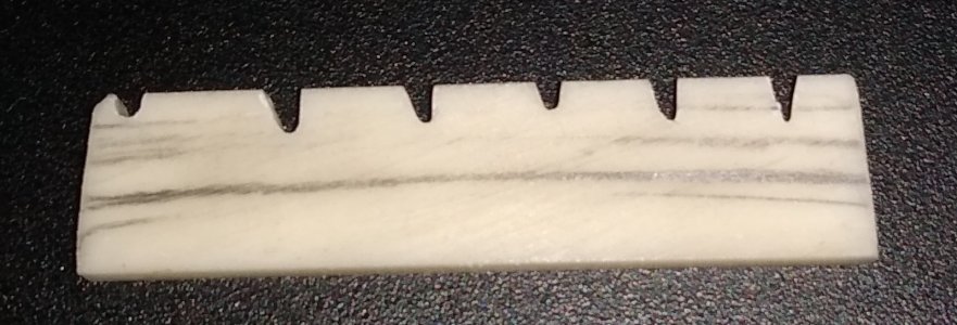

Here's my first one. It was super hard cutting the slots in the right spot using the "mark either side of the string and saw in the middle" method. I will at least print a template next time.  I didn't round the corners yet because I didn't want to bother until I got the slots right. And them hosco files go FAST. REAL FAST. (Hence the squaring/thickness jig.)

I tried to eyeball from the previous nut and you can see my spacing got a bit off - the G is way close to the edge.  I think I screwed this one up when I was trying to center the saw in between the markings from the strings. It's the old 'which side of the road am I on' parallax issue. (Put your right leg down the middle - no matter how big a truck you're driving), Anyhow I got it wrong this time.
I've got a bag of unslotted blanks. I might try another when I get my fretless board sanding done.

Ok fess up time. That's actually the second one I got thickness sanded. I boogered the first one (which I sanded to thickness with just my fingers and sandpaper) before slotting it.
The jig is well worth it
Looks like them files are gonna get some more use...

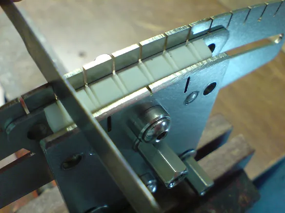

This little jig lets you cut guided and properly spaced slots, among other things. It takes a bit of cogitating to figure out how to use it, but you can make flawless nuts with it. Have to make a lotta them to justify it's price, but that's up to you.

I'll pass on the convoluted jig (or attempting to make one). I did however order a nut string spacing ruler. And another 10 blanks. I figure 1) I have enough nuts to cut across projects that I ought to be decent enough at it soon, and 2) if I went and got them all done professionally at once I'd be spending several hundred bucks.  And that's not counting the ones I'd just like to experiment with.
