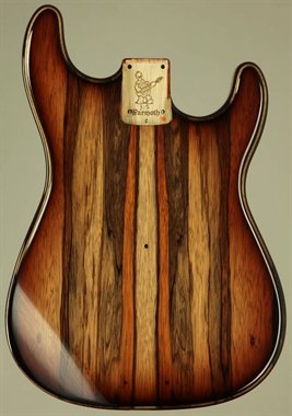

So i just purchased a beautiful black korina chambered body. I was thinking of just getting a regular maple strat neck, but was wondering if there are any better options which would complement the body more. I was going to put the David Gilmour pickup configuration which is fat 50(neck), CS 69's(middle), and SSL 5(bridge).  And I am also having trouble deciding between black or gold hardware. Im open to any suggestions so just let me know.

That is incredibly gorgeous.
In my ignorance, I wonder how do you rout a body that already has a finish on it.
To be more precise (and helpful), I don't think there is anything special to do just because you're working on a finished body. If you want to route it, be sure to use a quality bit (i.e. a sharp one), push the router in the right direction (regarding the rotation of the bit against the wood) and work in small passes. Which is what you have to do when you're working with bare wood anyway. Use masking tape if you want to be sure the finish won't be chipped (but it shouldn't if you have a good bit — I doubt Warmoth use tape on the showcase bodies they route according to the buyer's request); masking tape will make it easier to draw lines and align templates though.
danimal, this is a really nice body. I think a maple neck could work very well. If you want something similar with no finish, you could try a canary neck — it will be a bit darker than maple, perhaps more reddish depending on the particular piece, but it would still work with the shades of the body and the natural binding, I think. Regarding hardware color, I think gold would be over the top, and black too dull, so chrome would be my choice, but this is highly subjective, so... it's your build, it's your decision.
By the way, you may want to ask a moderator/admin to move your thread; this category is for finished builds, a sort of showcase.
Thanks alot for the advise I reely appreciate it. I did a little more research and im thinking of going with either wenge or pau ferro neck. Actually the body is already routed thats just the picture from the showcase that i saved before I bought the body. I'm still waiting for it to ship.
I'd vote for Canary. Looks good, feels good, doesn't need a finish, would match that body nicely - what's not to love?

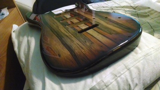

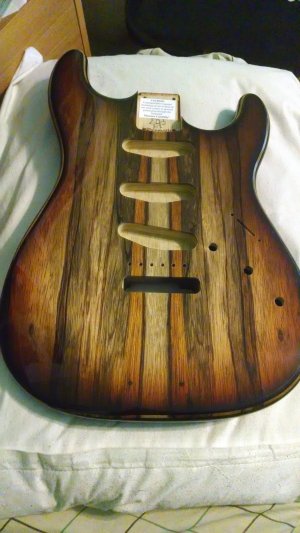

The body finally arrived so here it is. Im still taking neck suggestions and im still trying to decide the color of the hardware.

Well that is sexy as hell. :icon_thumright:
I'm a Gilmour devotee, too - I was planning on going the SD SSL-1 Neck/Middle, SSL-5 Bridge route, but wound up splurging on a Bare Knuckle Mother's Milk set to try and hit a lot of bases - that's getting assembled soon so I'll report back.  I do have another Strat with EMG SA's and love the neck and middle sounds but I didn't much care for the single coil bridge, so that got swapped for an EMG-81.  If I had the mid-boost like his signature set includes then a humbucker probably wouldn't have been needed to get to the same ballpark, but meh, lol.
I think the things that stand out to me about Gilmour's tone from the "his hands" part of the equation most are the clarity of his pick attack, the great intonation he has with the pitch of his bends, and the way he uses his trem for that really consistent vibrato.
Neck-wise, with that body I'd lean Canary/Wenge or Canary/Ebony.  Raw neck, reported maple qualities, "bright" dense fretboard wood, comfort, and cosmetically either would look great with the Limba/Korina.
