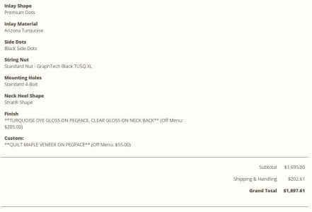

The neck needs to be a custom build, I put together a 3A flame neck, conversion scale, Vortex headstock, with wizard profile, 6100SS frets, turquoise dots and also I asked for the rare matching headstock. Even if the neck is flamed I have been told it will require a veneer nevertheless.
I hope Warmoth will be able to match the torquoise veneer and dots with the current body recreating the "sunburst" finish as well.

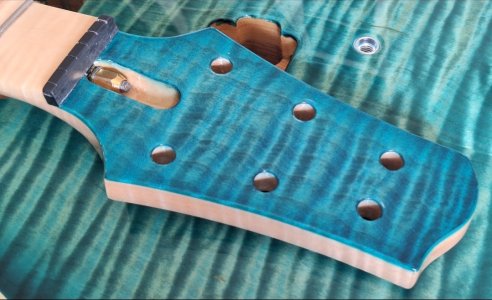

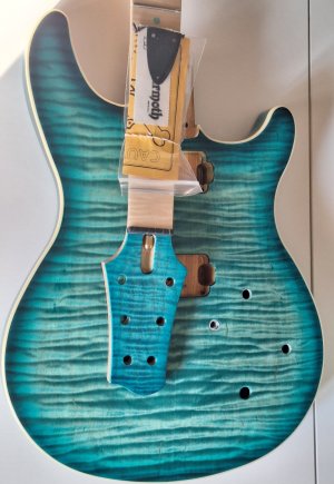

I finally received the kit, after paying 450 euros of custom duties (so long for Warmoth to include the fees in the $200 extortive shipping fees) ...and it was a serious disappointment.
First, the matching headstock doesn't not match at all the body which has a sunburst finish, while the neck has no gradient and the colour is more blue than green:

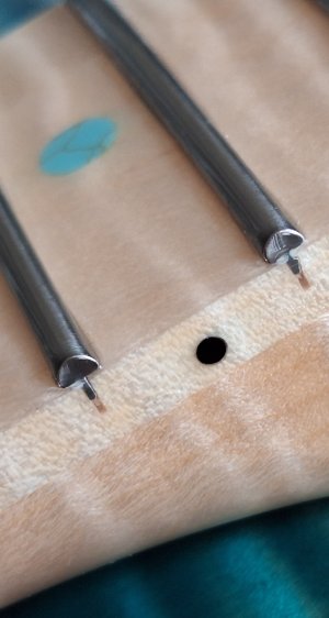

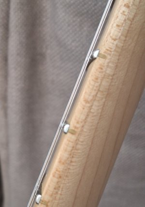

The cuts for the frets are almost twice as deep as they should be:
For comparison, this is how a "normal fretboard should look like:1000042023.jpg
And this is a picture from the Warmoth blog which shows their "standard" fretwork...spot the difference!

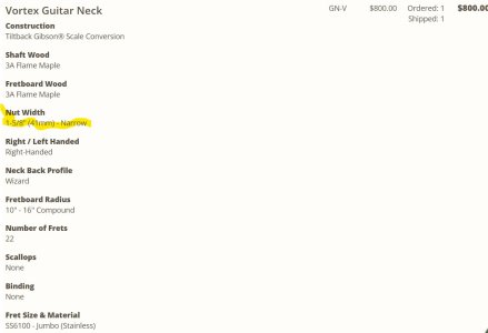

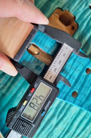

The most astonishing thing is that I ordered a 1 5/8' nut width neck or 41.3mm and I received a 42.8mm tagged as 1.625:
However I checked and I can confirm a R3 FR nut would fit this neck, these were the specs:
I made these points to the Warmoth customer "care" and what I received are passive aggressive answers like : " they are two different pieces of maple, it's normal the color is different" (despite of the clear gradient difference), "the frets slots are in specs and 6100s need a deeper groove (according to Dunlop specs the tang height is virtually the same) and an implication that I cannot measure correctly the nut width which is nevertheless 41mm because it is printed as such.
I asked to have the neck remade according to my specs and the answer was that this is not possible because I installed the neck on the body therefore the warranty is void (then if the neck would have not fit the body I was also supposed to lose my money because of this? Really?).

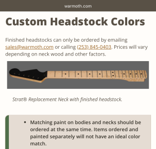

They are pretty up-front about the fact that pieces not painted together will not have ideal match. I am sorry you are disappointed, but I don’t think your expectations were realistic. For whatever it is worth, I think both pieces are gorgeous.
