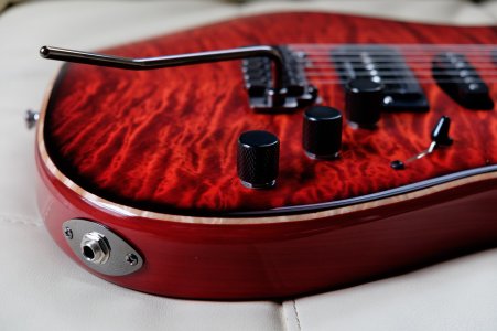

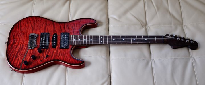

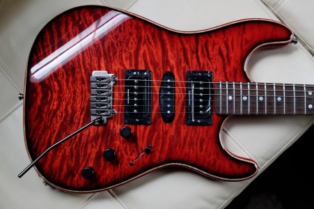

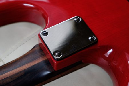

Been using Warmoth parts for a while to constantly keep changing my guitars... and finally decided to post pictures of my recent build. I might have a gone a little overboard on that one...
It started when Warmoth re-stocked their showcase with 2-piece ebony necks this summer.
I was aiming for an all-black Strat, but I let the idea sit for several months, it's only last month that a red chambered Strat body showed up in the showcase and that seemed like a good match for the neck.

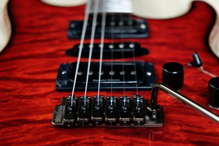

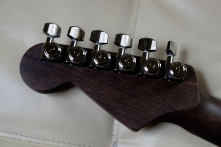

Hardware is a mix of ruthenium (tuner, strap locks) and cosmo black (neck + audio plates, Wilkinson bridge), both finishes turned out to be pain to locate but overall I really like the look of those parts.

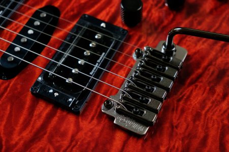

I thought about getting Lace Duallys + middle Chrome Dome pickups but was too impatient to complete the build and found SD P-Rails triple shot humbuckers and Dimarizo 61 pickup in local shops. The array of tone configurations is fairly overwhelming but I end up mostly using the series, P90, or parallel configuration of the P-Rails.
Now, let's hope I don't come up with another build idea for those bocote necks they recently put in the showcase....

I was at first disappointed with positions 2 & 4 which were extremely weak, it turned out the P-Rails and DiMarzio were out of phase and reversing the +/- on the DM got things back to normal. I assumed there was a convention or the polarity between manufacturers...
I was't familiar with HSH pickups when I started this one, and it took couple weeks searching for various pickups/audio clips and all that 'agonizing' stuff.
I considered DiMarzio Vai Evo, Alumitones (discarded those early on because they were too light to be paired with the already light body and heavy neck), Lace Dually +Chrome Dome, and eventually settled on P-Rails with Triple Shots which were available locally.
I liked not having to add extra switches to the body or push pull pots and yet get so many (too many) configurations.

I tried putting a veneer on the peghead the last couple days and failed miserably so I'll just use black or clear lacquer for the headstock...

Not that I played the guitar a whole lot more since last time (in the process of building a Regal as well as a small 1x10 amp cabinet) but I'm quite happy with the pickup combination after all. The volume is quite balanced and Strat-like between the middle pickup and the humbuckers split or in paralle.
I mostly find myself using those humbuckers in series or parallel though, so the triple shots are a bit overkill for me but still a convenient way to avoid putting couple push-push/pull tone pots.
