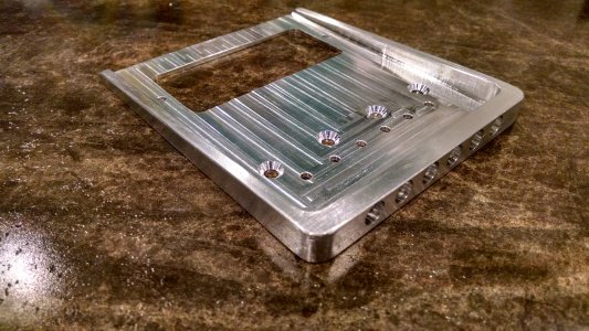

So I've been planning an overhaul of a Warmoth Tele for a while now. I ordered parts this week and immediately ran into issues. I got a bridge plate from Guitar Parts Global to fit a Duncan mini humbucker. It was supposed to work with 3 or 6 saddles (I am using Graphtech Ghost Strat/Tele saddles). The first problem was that the Duncan mini hum didn't fit in the bridge cutout. This was fixed with a little filling. The next issue was that the bridge plate wasn't wide enough to cover up the full size humbucker route in the body. The third issue was that the bridge wasn't long enough for the ghost saddles. It really needs barrel saddles. So now I'm thinking the best option is to fabricate my own bridge. I've come up with 3 possible methods: 1. Use stainless steel plate and bend a kick up in the back like the gpg bridge. 2. Mill a bridge out of a block of aluminum - probably 7075. 3. Make a flat stainless plate and add an aluminum or stainless piece to the back for the saddle  screws. Does anyone have any experience that might apply here? Obviously the goal with this guitar is not classic Tele tone, but I'm looking for the guitar to be brought with plenty is mids. Thoughts?

Sorry, I sort of forgot about this post. I ended up machining a bridge out of aluminum. I still need to drill the holes for the ghost saddle wires and polish the the outer lip but here it is so far.

Very cool.    :headbang:  I've made a couple of Scartozi's designed bridges for Ghost saddle set up.

Nice work love the color too.
