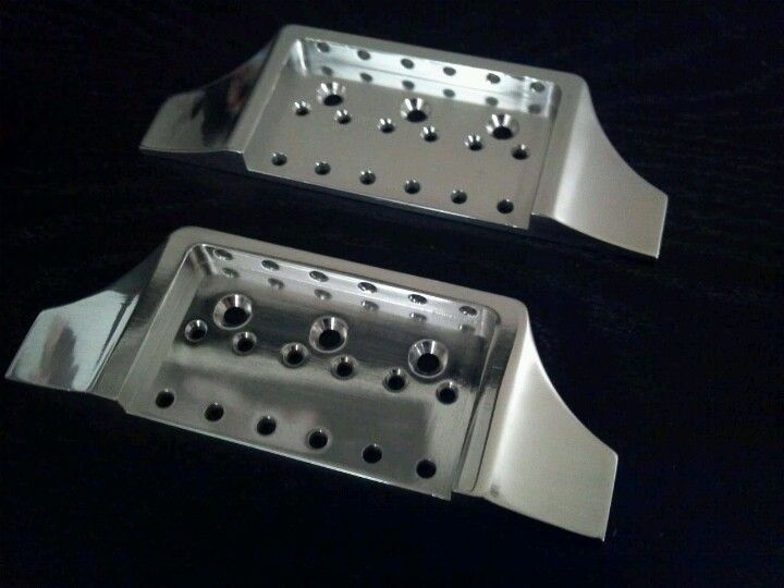

I vaguely remember those Scartozi posts, though I thought they were tele bridges???  Does anyone have any pics of the Scartozi strat bridge?
There used to be a company that made plates like these to cover trem routes. They even made ones with a flame shape. I don't think they were big sellers.
Scartozi bridge was an acoustic looking bridge made from metal to fit a trem routed strat. Most of the pics are lost to time (Photobucket) but here's one on Pinterest
I see, though once you install it, there's no going back?, like permanent holes that will be not be covered if you put the trem back?
Not 100% positive without going back but I think those holes are either/or. Six are obviously for string through if you chose that. Front six are for screw fulcrum trem hole mounting. Back three are for hardtail mounting. I imagine you could probably mount only using the outside two fulcrum screws and string tension and it'd be just fine.
I think Doug (DangerousR6 on here) made some Scartozi-style bridges, perhaps he'll notice this thread and weigh in?
