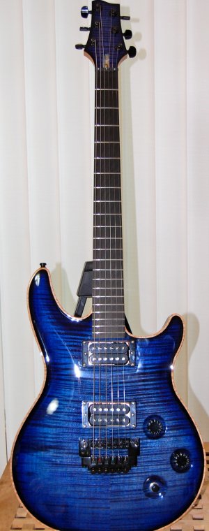

Body: VIP Carvedtop body, Flame Maple carved top/Alder back with black pinstripe, and recessed PRS controls, Schaller 456 bridge, The finish blue dye top/natural mask binding/blue transparent back.
Warmoth neck is maple/black ebony fretboard Earvana Black Tusq nut. Finished Blue Dye Gloss Peg-face, Clear Satin Back.
Electronics are from Andy Rothsteins Guitars and has a PRS-Prewired assembly with VCAP, Vol Kit & Short switch
Andy had Lindy Fralin hand wire my pickups with a Fralin Bridge Humbucker 9.5k and a Fralin Neck Humbucker 8.5k.
The workmanship is far beyond what I can imagine and the finish is like glass. I am currently building a Strat now from Warmoth.
