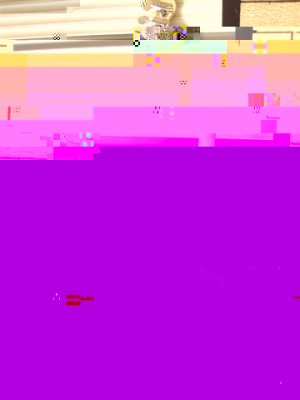

willyk
Senior member
1,278
red king said:
that's my goal - however, since swamp ash is very porous, the dye absorbed rather deeply into the wood in some spots and it's tough to get out.  I don't want to sand the body too much either and lose the contours.
I mixed black stain with grain filler to re-finish this body,(it was originally clear gloss). After it dried I sanded it off starting with 400 paper and worked up to 0000 steel wool. It hasn't blunted the contours any. Maybe this is similar to what you are after? I wanted a relic-ish look so I left a few patches in the black and satin coated the whole body but I could have cleaned it up a lot more............hope this helps. Willy
